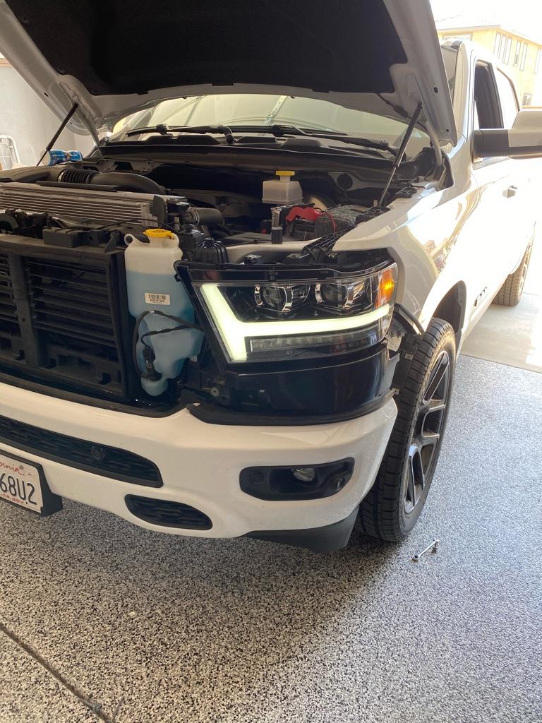

All reassembled, will have to wait for tonight to really see how they look. But initial reactions are the DRL strip is much less obtrusive and looks good even with the paint matched grill on a black truck.
The chrome on the projectors is much more subtle and the housings are mostly black - less ‘chrome’ than the stock reflector for sure. It looks much better than I was expecting honestly. Also have the Lasfit LEDs installed so will see how they look.

As far as tips, the shroud on either side of the grill is a major PITA, I partially broke clips on the middle lower aspect of both near the grill. Both okay for now reassembled but will have to keep an eye on them.
