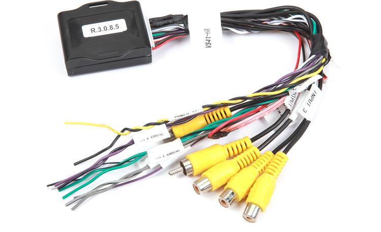

Has anyone put a video switch in so they could manually change the feed from CHMSL to FRONT cam? Seems like since it’s analog it shouldn’t be too big of a deal. Finding a good switch hiding spot may be the worst part on these trucks.
I have a 19 power wagon level one with the 12” nav unit. Does anyone know if there has been success with this on the PW? From reading other posts I know their stuff is slightly different for some settings.
I've though about that. I think this would be a good option... I bet you could add a switch to one of those wires to make it work.
