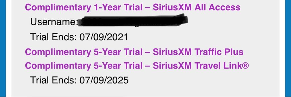

Did you need to register the sirius id before this came up. Usually new modules in demo mode, it shows nothing on sirius web page, then you register to show subscribed. Just curious.![]()
stead of going through the disassociating previous week IDSo I understand. You just created a different email address and registered this modules id with the new email address. That is how you think you got the 1 year and 5 years freeYes i just used different emailstead of going through the disassociating previous week ID

I understand. The module had the 5 years and 1 year in it from the factory. What was odd was the 1 year sirius started the day you posted here. The module must have been in demo mode when the truck was wrecked that the module came out of. Did you need to enter the pin code? My guess is no if it was in demo mode
A lot of junkyards go in on joint ventures for revenue sharing, and they’ll buy brand new trucks strictly to part out. If you look on car-part, and notice the same radio with the same stock number being sold by multiple wreckers, chances are, the part is off a brand new truck. That’s where my module came from, also, so no radio code prompt, and it is in demo for the free trials.Ahh I see what your saying no I didn’t

Did your stay in demo mode or did you hit the button for free trial on the screen. Curious because I am wondering if the free trial of 1 year sirius and 5 year traffic goes with module and you need to hit that trial button to get the 1 and 5 subscriptionsA lot of junkyards go in on joint ventures for revenue sharing, and they’ll buy brand new trucks strictly to part out. If you look on car-part, and notice the same radio with the same stock number being sold by multiple wreckers, chances are, the part is off a brand new truck. That’s where my module came from, also, so no radio code prompt, and it is in demo for the free trials.
I’m still in demo, and haven’t hit the subscribe button yet. I haven’t kept any of the transplanted radios I’ve had long enough to know for sure, but I’d imagine the trial will keep running until expired no matter how many vehicles it moves to.Did your stay in demo mode or did you hit the button for free trial on the screen. Curious because I am wondering if the free trial of 1 year sirius and 5 year traffic goes with module and you need to hit that trial button to get the 1 and 5 subscriptions
