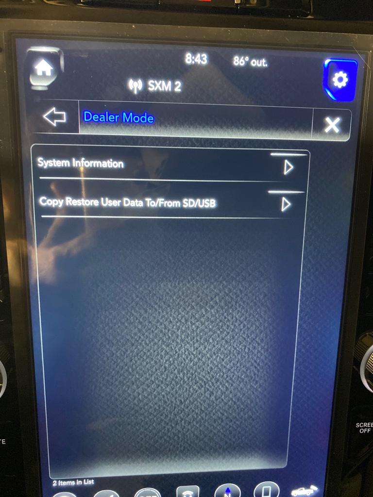

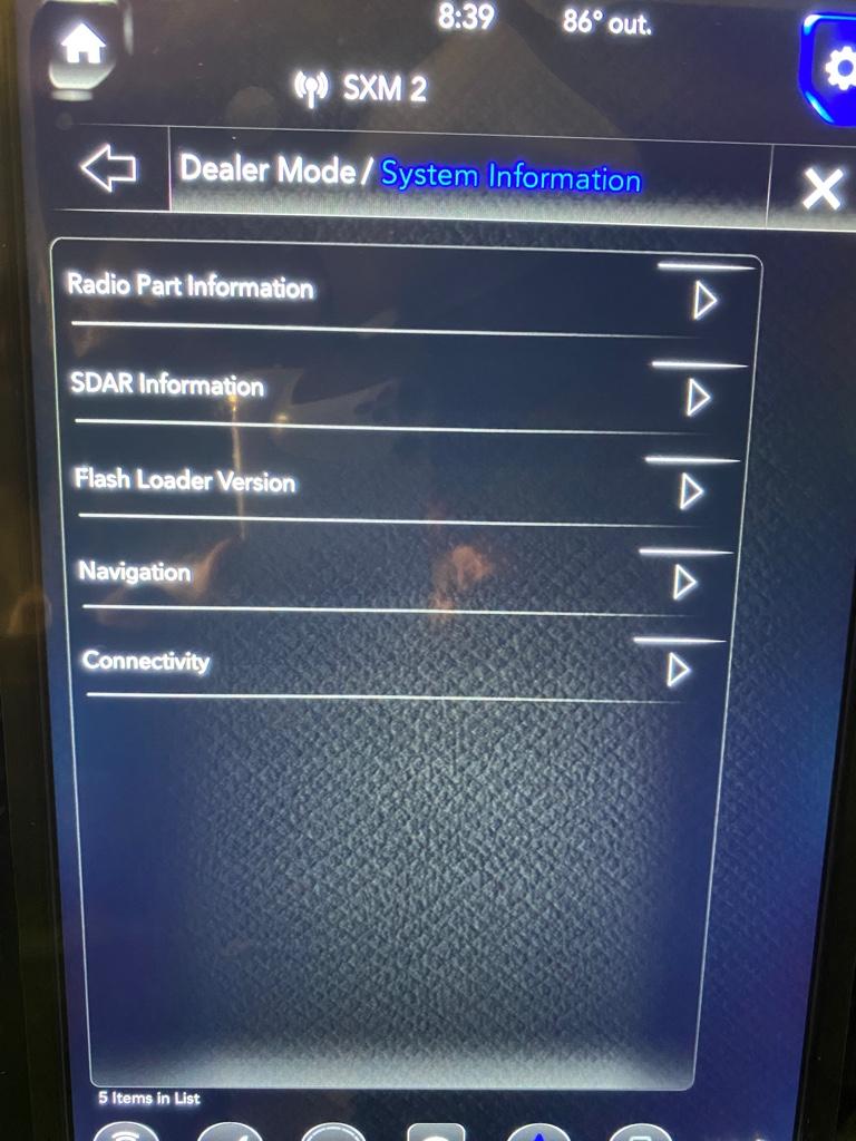

Strike that above. If you’re using the kaodtech style bypass, you won’t be able to connect to the radio module. You have to pull the radio and get the part number off the Module, and you need the serial number off the module anyway.In AlfaOBD, instead of selecting body computer to connect to, select radio navigator module 2017. Connect to it, and select the faults and status log tab. Select read system ID, and that will reveal the radio module part number.
Trust me, you’ll choose the 8.4 UAX selection pictured.
