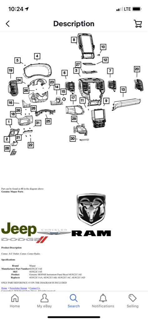

I’m not sure what you mean by that. Are you referring to the number of the part on interior trim parts diagram- like this-
It’s number 13 in this parts drawing version, but could be different on another mopar site drawing model. There are 22 different part numbers for part number 13 in that drawing (I’m talking actual different part numbers, the series of 5 part numbers you posted above are all the exact same part). Unless someone posts a photo of the bezel with the part number they’re referring to, it’s easiest just to find the vin of a truck with the bezel you want to make absolute certain you’re buying the bezel you want.
I guess it all depends on where you look..... it’s #3 on this diagram
Right, but for #3, there’s 22 different variations of that part. How do you know which part number to tell someone to get when they say “which one is diesel gray and black”?
