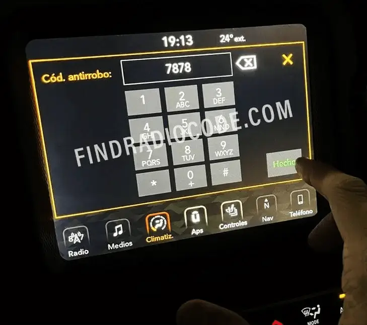

Hopefully somebody can help me out. I just upgraded from the 8.4 to 12.1 screen. The screen is on and everything works but I can get past the anti theft code. I purchased a code from the site on here everyone has recommended but when I enter the code, it says incorrect code entered. I’m not sure what I’m doing wrong as far as inputting the code or maybe they sent me the wrong code. Is there a way to retrieve the code using alphaobd?
I literally just did the upgrade myself about two hours ago. This is the website I used for the security code.
Just make sure you get the correct S/N off your radio module. Cost me $20, but well worth it in my opinion and VERY happy with the upgrade thus far. I also upgraded to Uconnect5.
