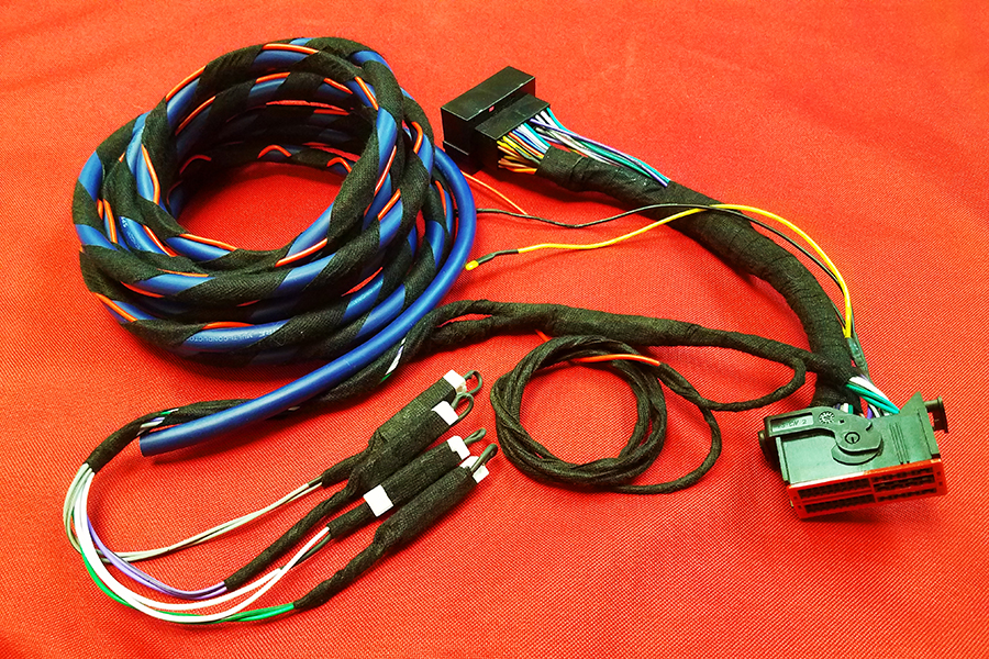

You need the harness that I got. I got mine from www.netaudio.com
I have zero complaints with this harness. It has the load resistors in-line so there is no worries. It also can come with 9 wire speed wire to loop back into the OEM wiring so you do not have to run speaker wires to your doors. You have the output side be terminated into RCA or ferrules.
This is the exact harness you will need. I have already talked with the owner of NET AUDIO and this harness does in fact work with the 5th gen rams. You will need the ANC bypass harness as well though.

Does this bypass the ANC? Can you hook up this unit without changing speakers?
Not sure, I know it takes the signal straight from the head unit and the factory amplifier has to stay plugged in for it to work so you don't have to replace anything if you don't want to
