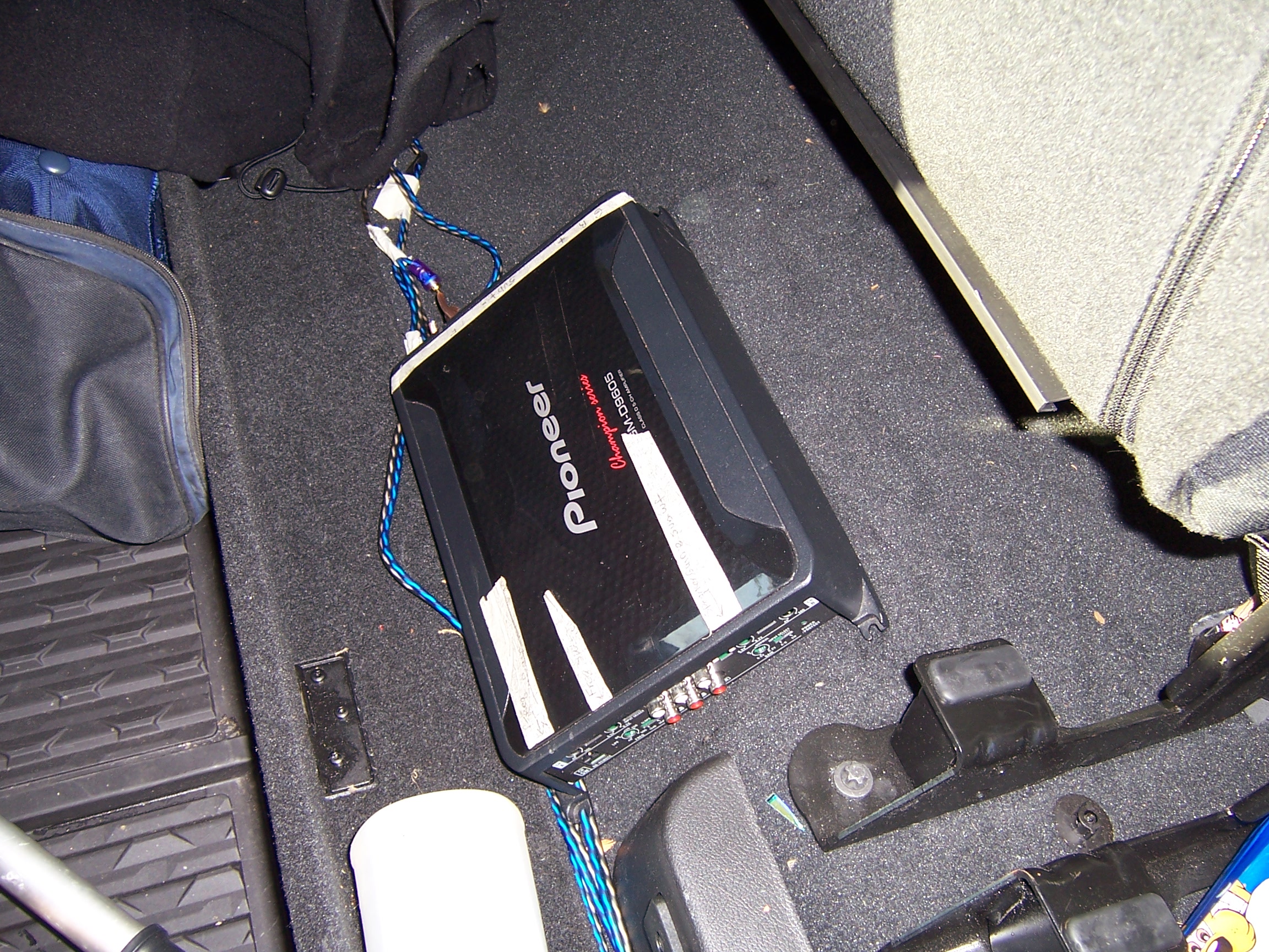

its what i did to.the dash and rear ceiling speakers are run off the stock amp! as for the doors,i ran wire from the doors to the 5ch amp (y)
I also used a 5 channel pioneer but used it to power the dash, headliner and a 12" sub. And I used a 4 channel for the doors.
