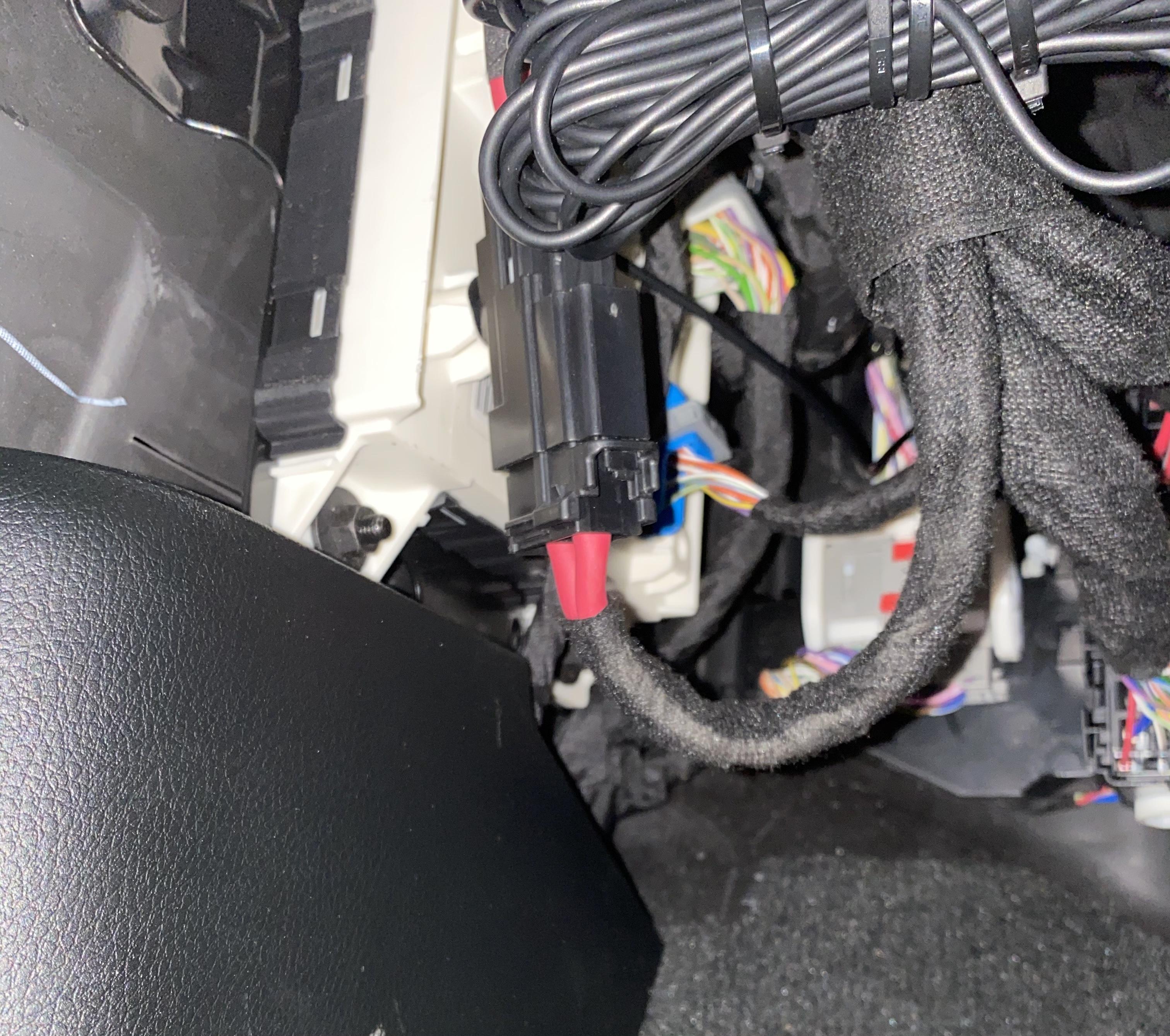

Here’s the particular plug that I found disconnected which caused my truck to be totally unresponsive and have no power to anything. If you look up and to the left of where your left foot would be resting while driving, you should see the black connector with the heavy gauge wires secured to the white housing. Ignore the bundle of zip-tied wires hanging there; that’s for my dash cam and I just haven’t gotten them further up out of sight yet. The camera was installed after I found and corrected this issue so it wasn’t caused from me pulling on stuff on that area. I’m not sure if it’s specific to the etorque trucks as it’s dark out and I didn’t follow where it goes, and can’t recall if it was on my bighorn or not. It definitely supplies a decent amount of power given the gauge of the wire. It’s in a spot where your foot could hit it at some point and knock it loose, especially if it wasn’t secured all the way to begin with like mine apparently wasn’t.
Edited to clarify location and extra wires.
