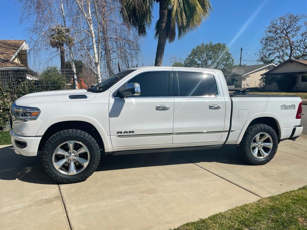

I have to agree with you. The firmer Bilstein suspension is welcome in my opinion. The truck handles much more to my preference than when stock. No more floaty grandma Buick suspension!
Thanks. I couldn’t agree more. After feeling it out for a couple weeks I am completely satisfied.
Got the wheels on yesterday
Did you have to trim any with that setup and your not on air right? I like that look it bout having to go up 6” haha
I am on the factory air ride, the pictures are in "normal" mode which I ride around at. Below are my components:
"Daystar 2.5” leveling pucks, rough country link arm relocation brackets, homemade air links in front. Homemade air links in rear. Total lift is 3.5” in front and 2” in rear."
I spaced the front bumper out 1/2", but I do rub a bit on the fender spats. I will get them modified with the metal behind it at some point soon.

Reverse leveled, with 1.5 inch wheel spacers on factory wheels and tires for now.. thinking of bumping the tire size but having too much fun burning off the stockers right now.

Bilstein 5100's on level 5, 35x12.5R18 Nitto Exo Grapplers, and Fuel Shok's 18x8 -12 offset. Had to bend the metal bracket behind the plastic mud flap, also trimmed off the portion of the mud flap that rubbed so i could keep those pieces on. Drives/rides like stock
Did you do anything to rear? Did you not to level 6 at front to keep some rake or other reason?
