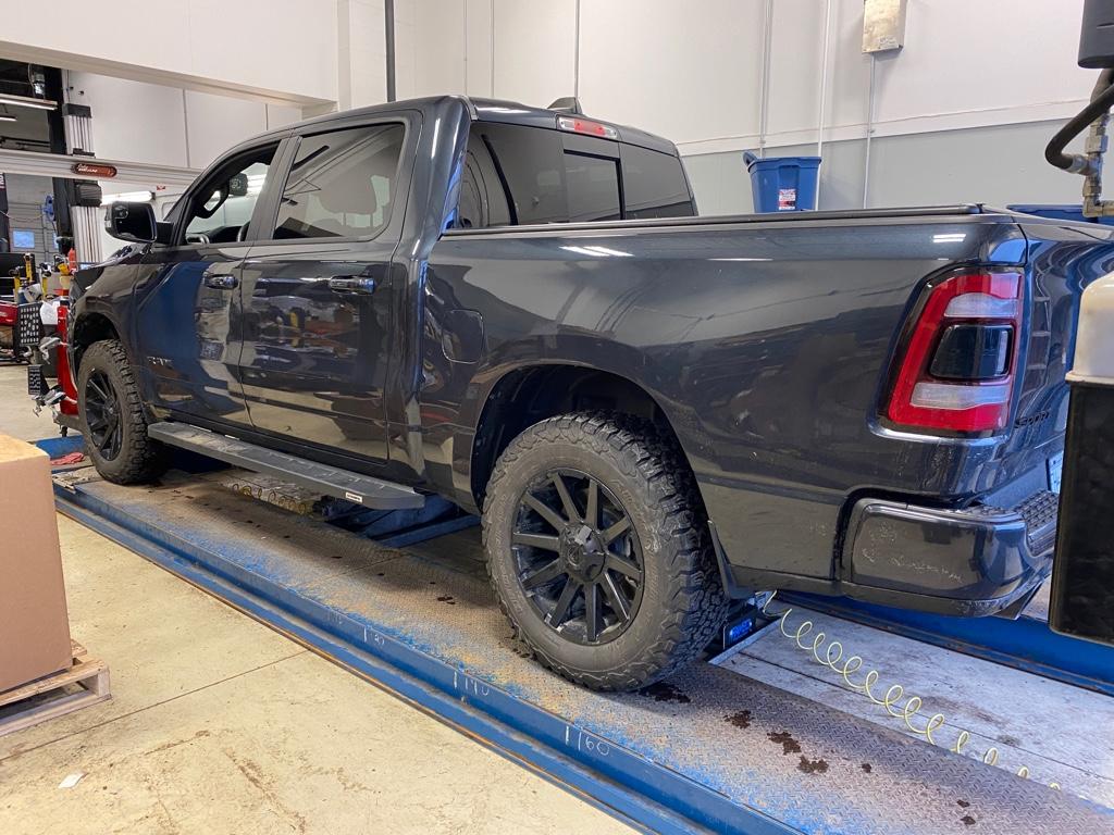

Bilstein 5100’s front/rear set at 2.2” and Nitto ridge grappler 295/70r18. Stock wheels. I’m happy with it. Still rides beautifully.
Really nice looking truck!
I have to agree with you. The firmer Bilstein suspension is welcome in my opinion. The truck handles much more to my preference than when stock. No more floaty grandma Buick suspension!
Looks great. No change to the UCA’s?
