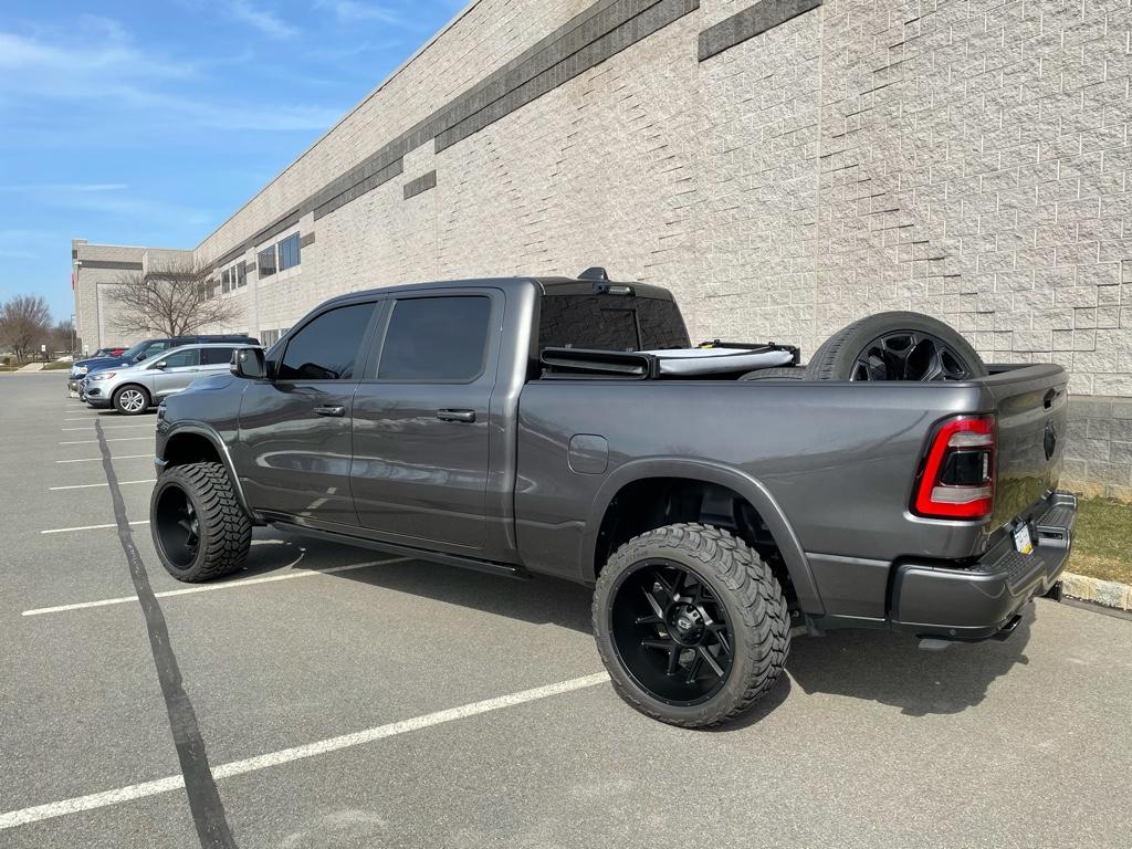

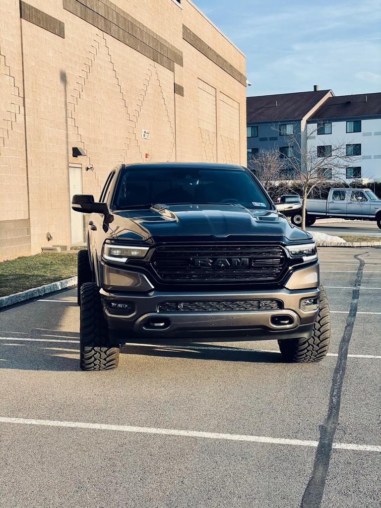

First post, here we go. Before and after pics attached. Love it so far, happy I went with 20s and not the 22s
2020 Ram Laramie sport night edition
Readylift 3.5” SST
20X9 XD820 Grenade Blk/Mil
35X12.50R20 Nitto Ridge Grappler
