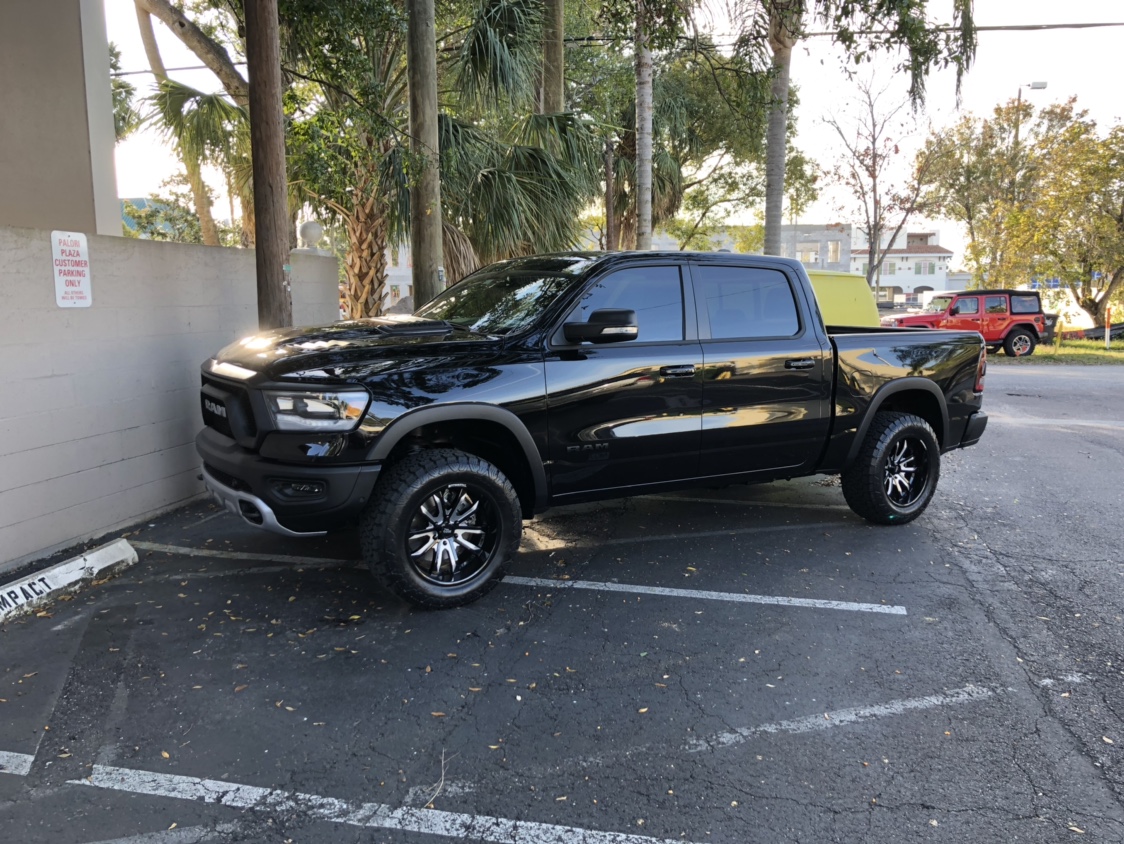

here it is.
2inch Rough Country Level ($55)
35x12.50r22 Milestar Patagonia MT ($187 per tire at walmart, 805 shipped to store, tax included)
Mount, Balance, Align at Tires Plus $225
Rough Country Speedometer Calibrated to 34inch tires matches GPS speed perfect
Trimmed the Wheel Well Liner, shown in pics. No rubbing after that. VERY TIGHT FIT, BUT FITS!!
My biggest worry is sticking with the +19 offset on the stock rims and rubbing the control arm with the 12.5 width....no issues?
Same here and can’t get a great answer. I believe we will need wheel spacers.. but can’t confirm.

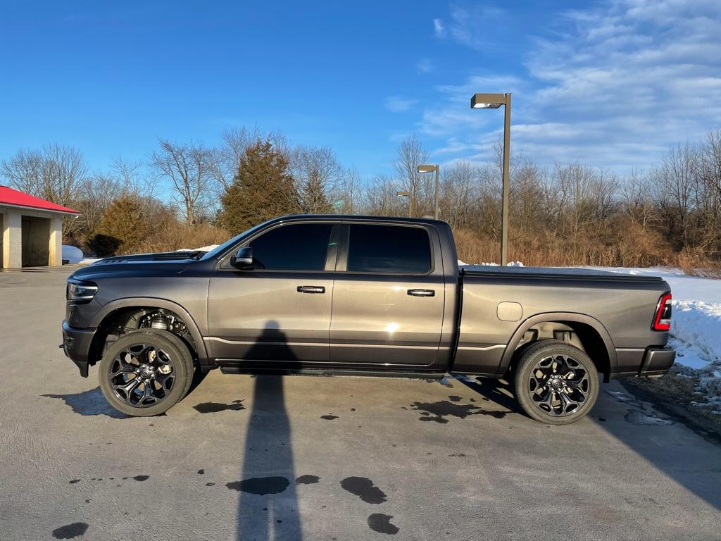

2021 Limited with air ride. Daystar spacers in front with Rough Country link brackets, and shortened links. Rear is lengthened links. Total is 3” in front and 1.5” in rear. Rides a bit more “truck like” now but not bad
Readylift 3.5”
Bilstein 6112s upfront and 5100s in the rear
Toyo AT3 35x12.50x20
Asanti Workhorse 20x10 -20
