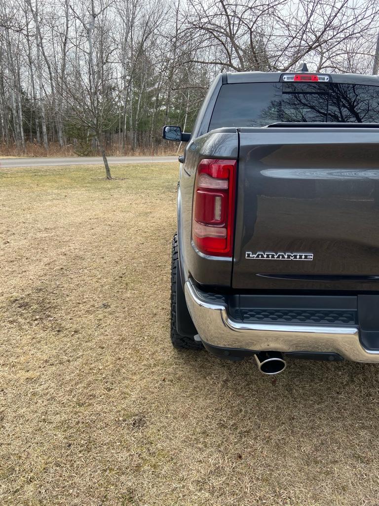

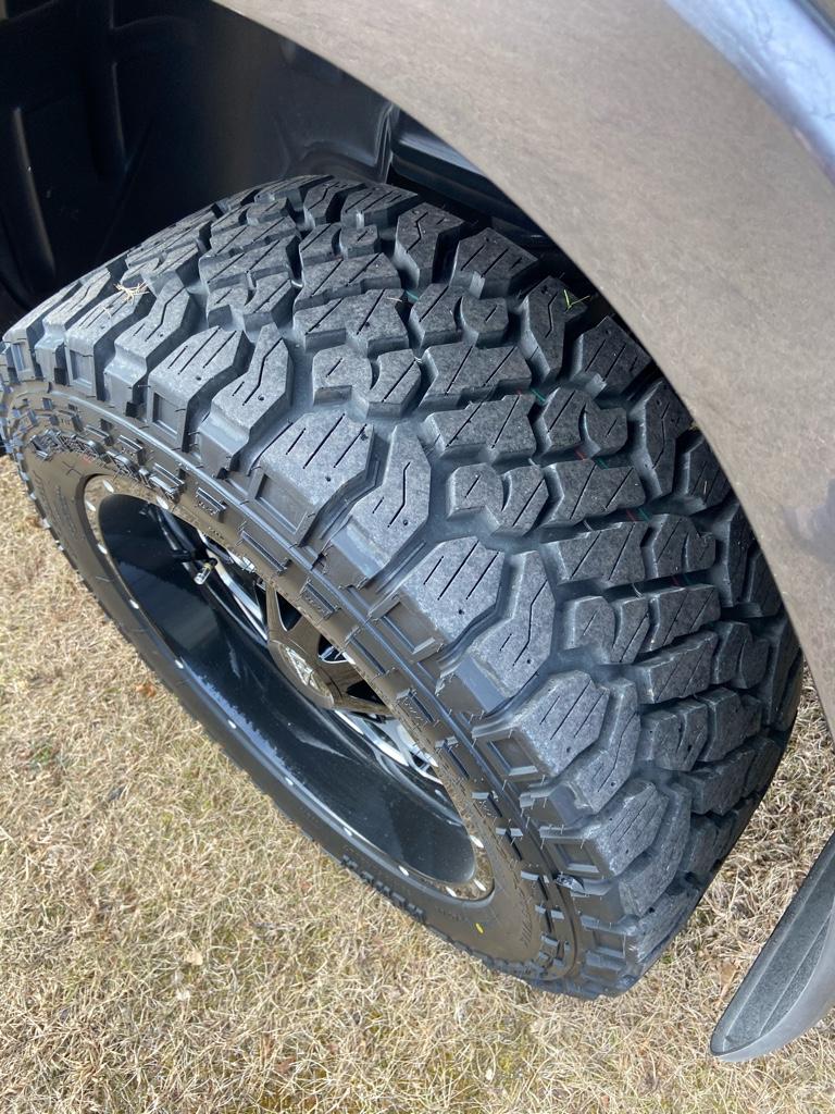

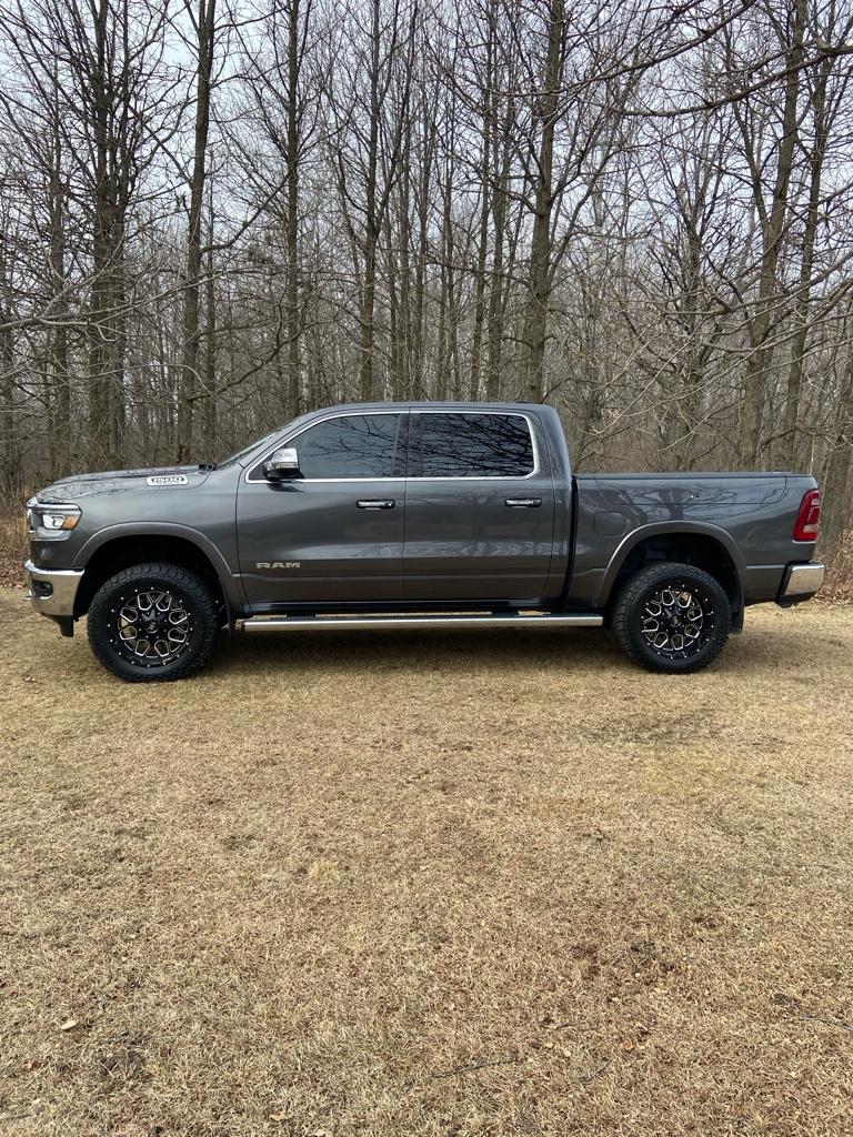

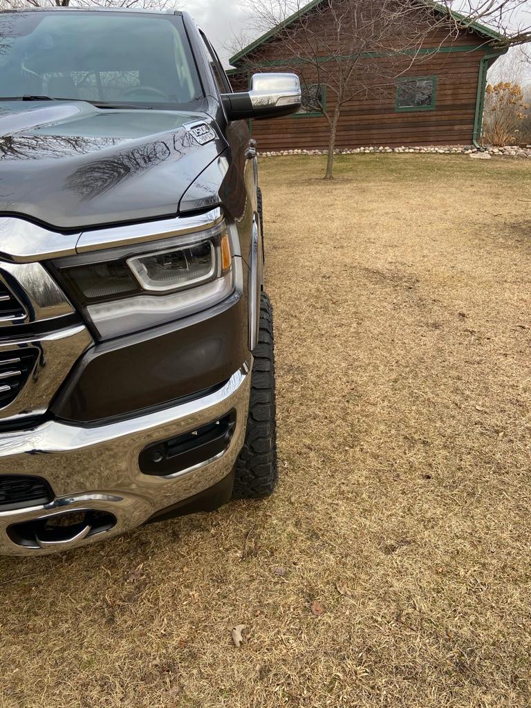

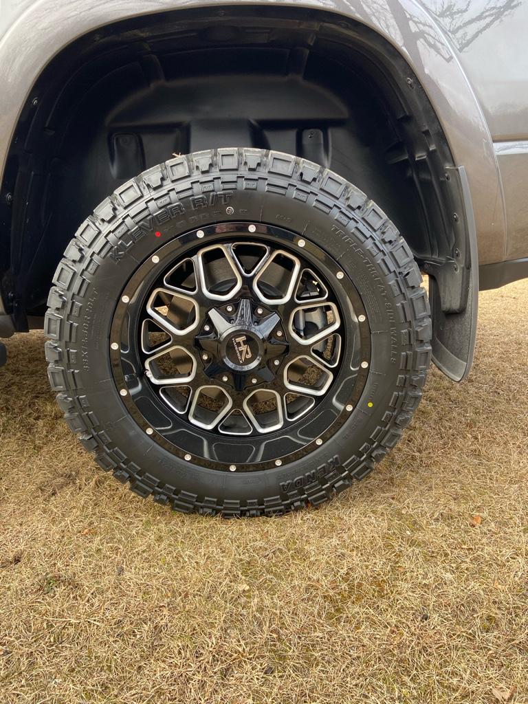

2020 Ram 1500 Laramie, Motofab 3” front and 2” rear spacer, 20x10 -19 offset Hardrock wheels, 33x12.50x20 Kenda Klever R/T tires, truck rides and handles great.
