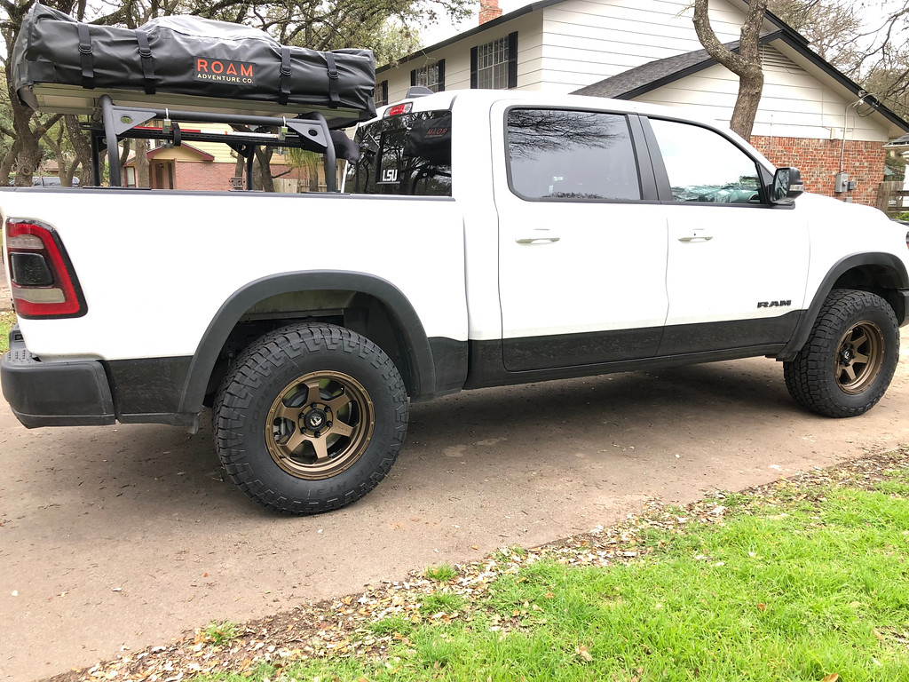

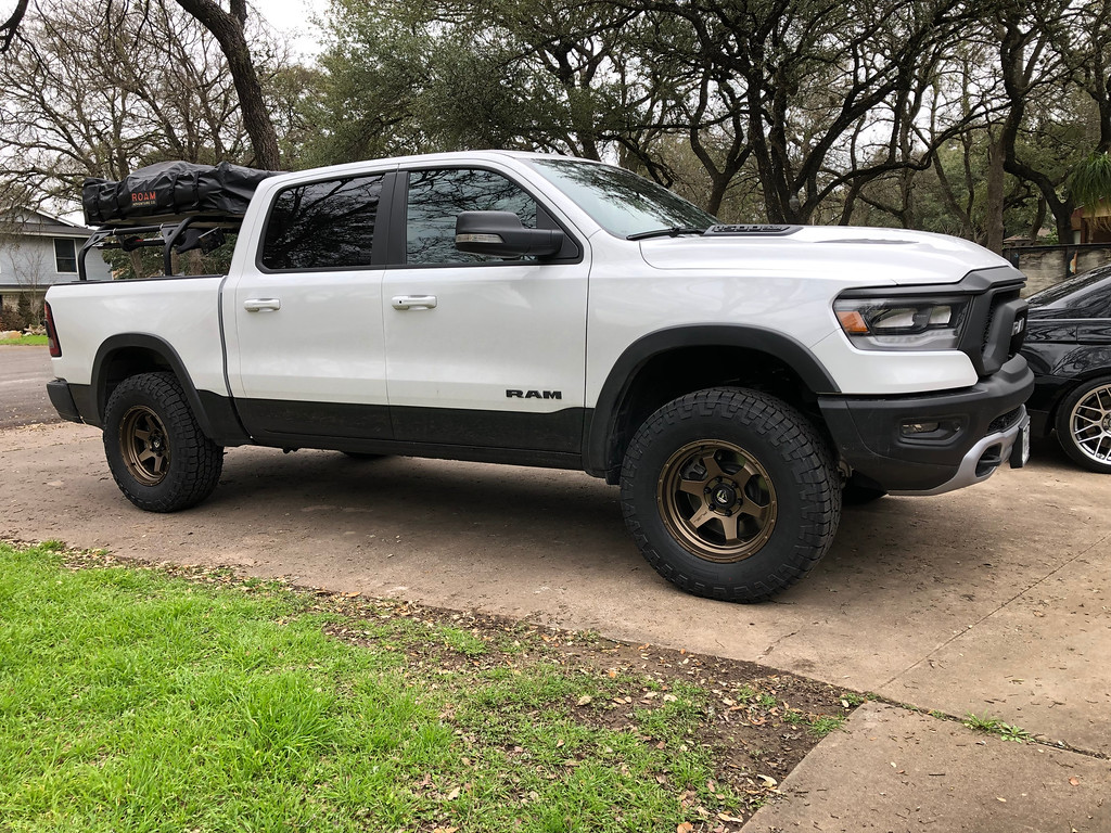

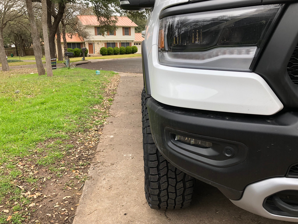

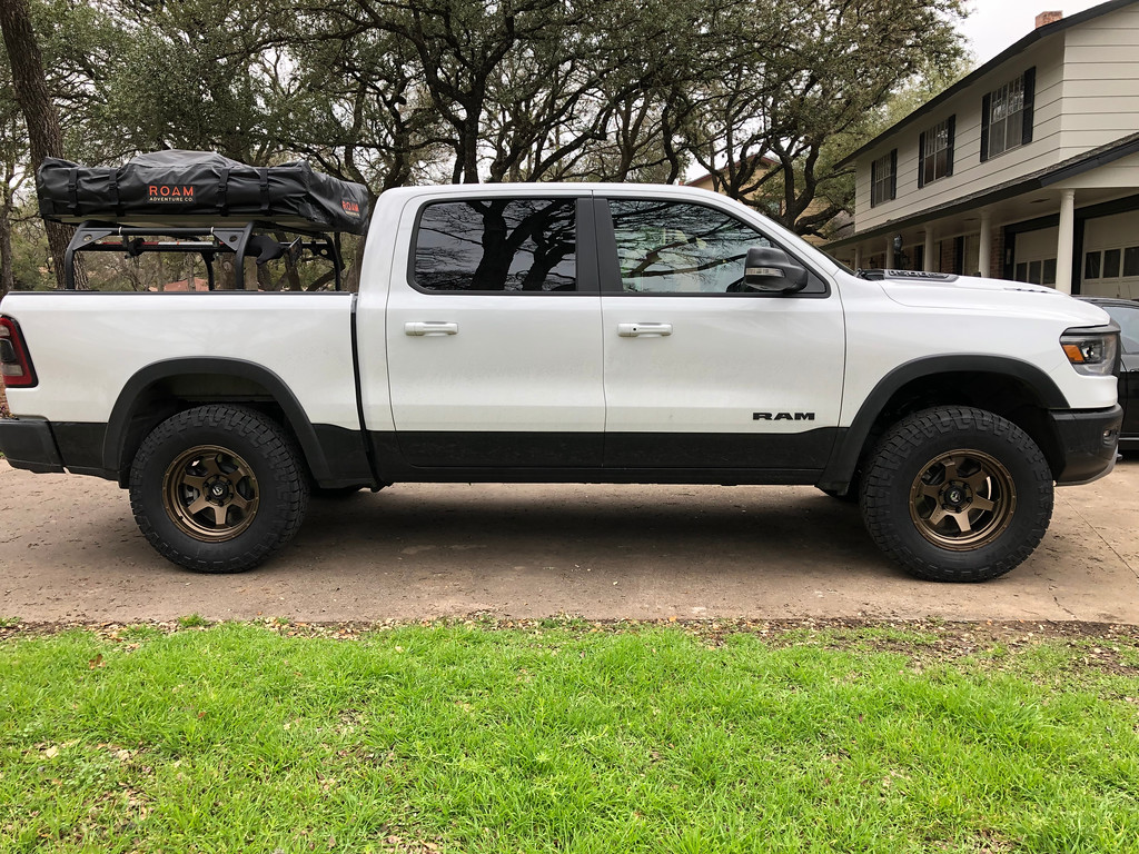

2019 Rebel with a 2.5" Motofab spacer up front and ReadyLift upper control arms. Wheels are 18x9 -12 Fuel Shok D666. Tires are Cooper AT3 XLTs in a 295/70-18 (34.25" tall). The rear is 1/2" lower than the front as it sits.....probably because the roof top tent and rack are weighing it down just a bit. I'll be installing air bags in the rear and could easily raise it to level the truck, but there's something I don't like about a tall leveling kit on an IFS truck. The arms droop down and narrow the track width. It's noticeable and I don't like that very much. I could either replace the spacers for a 2" version or widen the front track a bit with some 1" or 1.5" spacers.
Not sure what I'll do yet, if anything. Oh, no rubbing thus far.

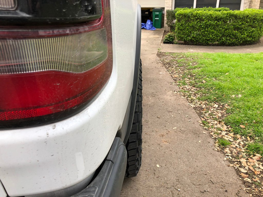

View from the front:
View from the rear:
View from the rear:
