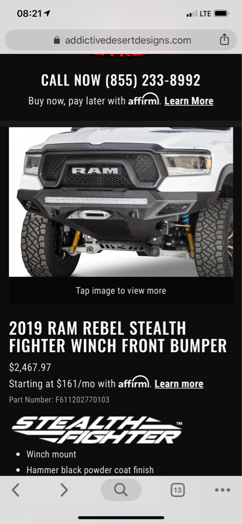

Any idea on this? I emailed ADD and they said the customer already had the lift when they installed the bumper, and now this picture is no longer in the site. But form what I can see, everything looks good....
That is @jamesfg if I remember correctly. Don’t know if he’s been on the site much but he is pretty active on the Facebook page. As far as I know he has been happy with it.
I just want to hear that “yeah it works” or the “ you gotta do this” lol. Kinda hard to pull the trigger on a purchase that significant without knowing for sure it works
