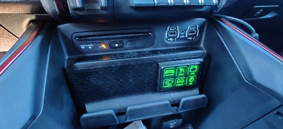

Took it to a buddy's house and got it done within 2 hours! Wasn't as bad as I thought! Appreciate the willingness to help though!If you need any help with it, PM me and we can talk via cell. Happy to help![]()
I got the switches but realized that where I initially wanted it, requiredme to cut the interior panels, which I'm really not a fan of. Instead, got a single button switch prewired to a harness and installed that. I will most likely install the control panel in the future. Having the practicality of a lit button already is a huge plus haha! Thanks for commenting!I would also agree that the decision you made as well as DTS828 is the better one. I think the wireless is a good option based on this experience only if you really don't want to deal with pushing through the firewall grommet. The wireless is a quicker install but not much, and for the trade off of no batteries needed, backlit buttons, and no risk of wireless interference the single wire like posted above makes more sense for way less cost.
