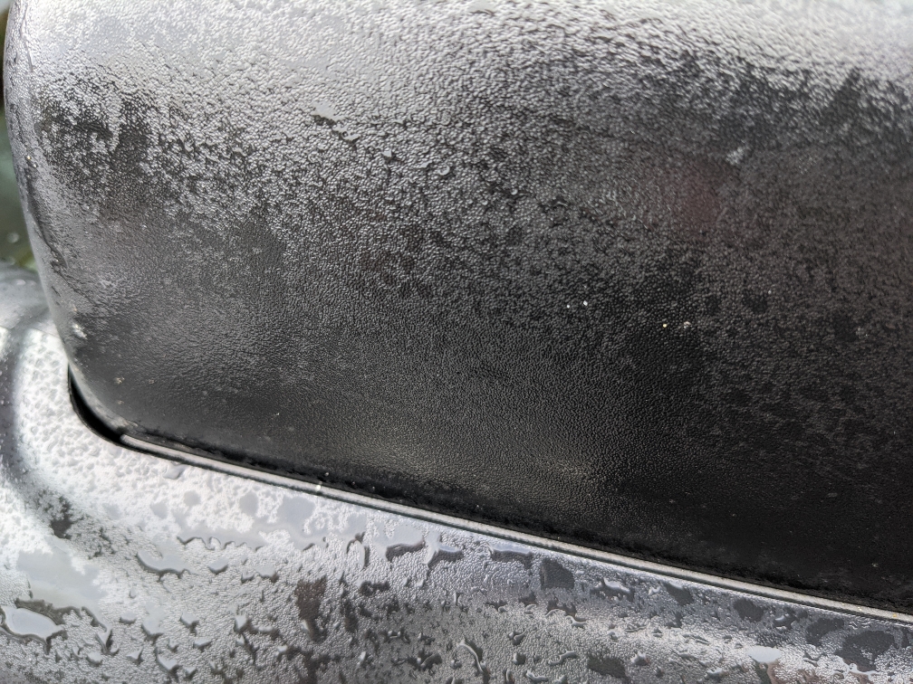

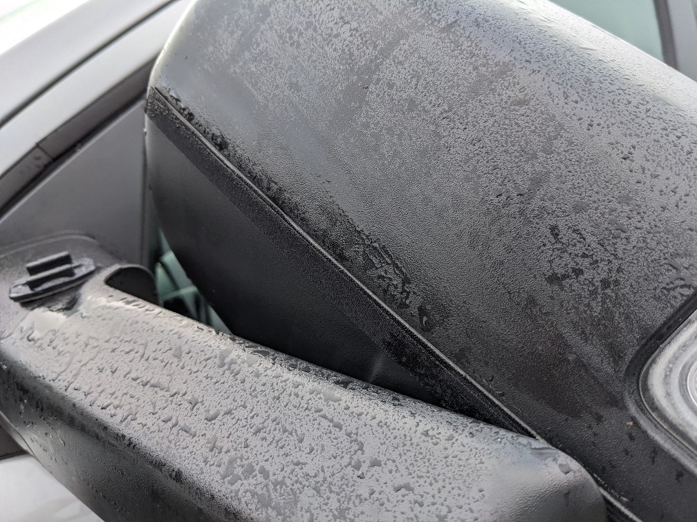

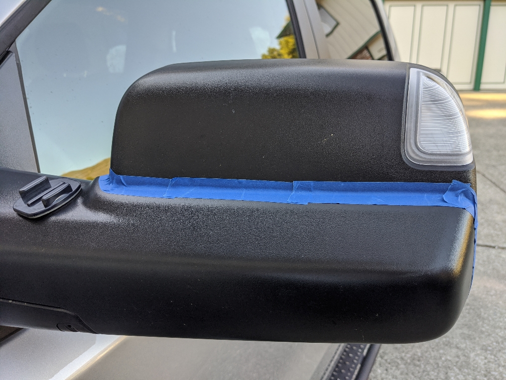

Assuming you have the tow mirrors this is how I got rid of the 40mph whistle.
Added some foam tape in the seam where the mirror folds. I first trouble shooted with blue tape to see if it would stop and it did.
