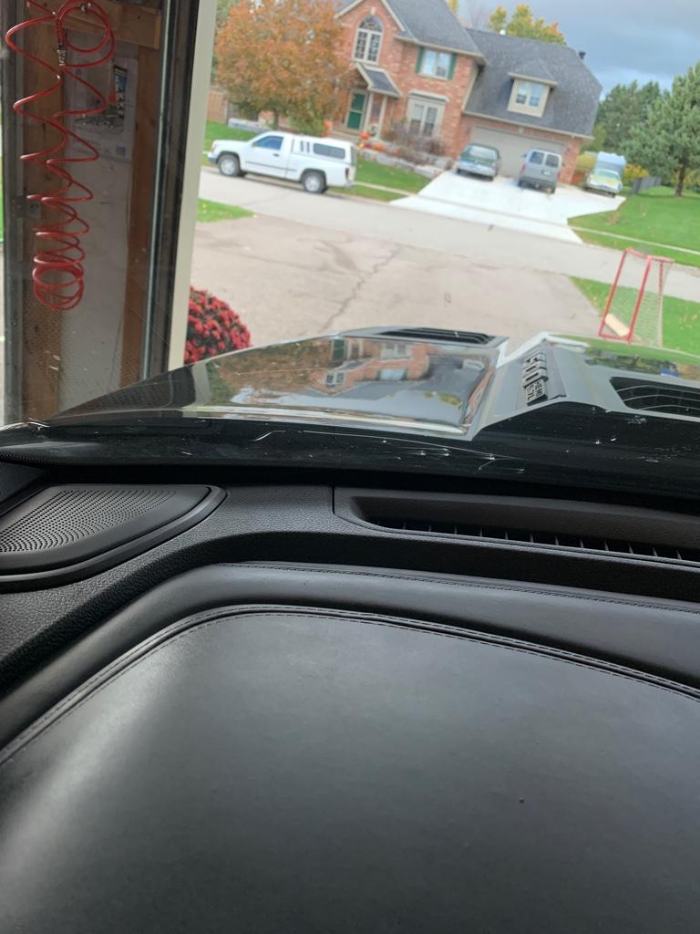

OMG lol thanks for sharing that. its exactly how I fixed my wind noise by stuffing a rag down deep in the dash lol. glad they finally recognize the issue.
Hello, I am trying to figure out this whistle noise also. Where exactly did you stuff the rags? Thanks
