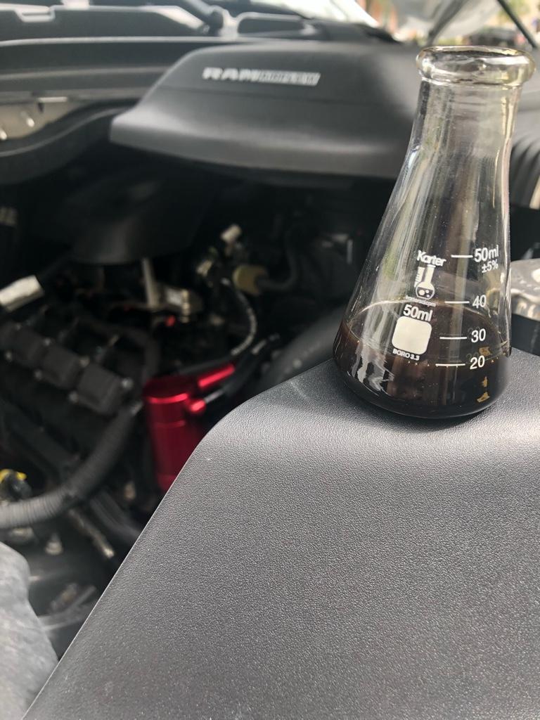

So currently just store it in an open beaker in your garage?![]()
I’m tracking the amount every 1000 miles. I’ll turn it in to a HAZMAT site once I have enough to make the trip worth the time so it’ll be awhile.
I keep an empty water bottle in my garage and just pour it into that. Over 9K miles on my RAM and I only have like 2-3 ounces at most.What are the majority of you doing with the oil & gunk you drain from your catch cans? Throwing straight into the garbage? Taking the time to put it into used oil containers and find a place to dispose? Dumping it down your closest sewer drain?Seriously.. I wonder what most people are doing..
