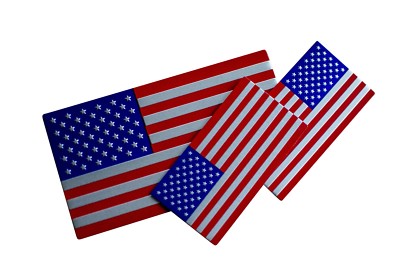

Below is the last (???) of my USA graphics on my Patriotic Blue Limited ... Aluminum USA Flags:
www.ebay.com
3D Aluminum American Flag Sticker Emblem Decal [BUNDLE] | eBay
PEEL: Remove paper backing off decal as well as the. front of the decal. STICK: Slowly lower the decal onto the clean dry surface and press down firmly for at. Material : Aluminum. least 30 seconds.

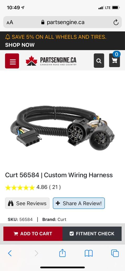

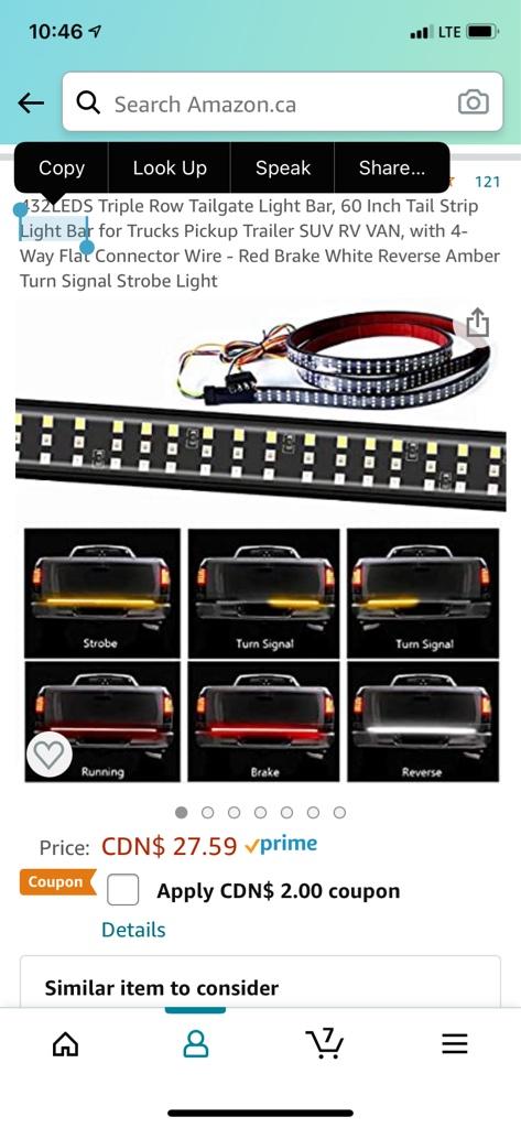

What LED strip is that (OPT7)? Did you wire it directly to the trailer connectors or somewhere else?
It was Easy and cheap. I first attached a 3/4” x 1/8”aluminum flat bar under tailgate using self tapping screws 1” long in to plastic areas only. I used 1/4” spacers to allow a gap for tailgate wire.
Then used this Curtis adapture for 5 wire connection
I purchased cheap light from Amazon
You do need to use one wire tie in to harness for reverse light

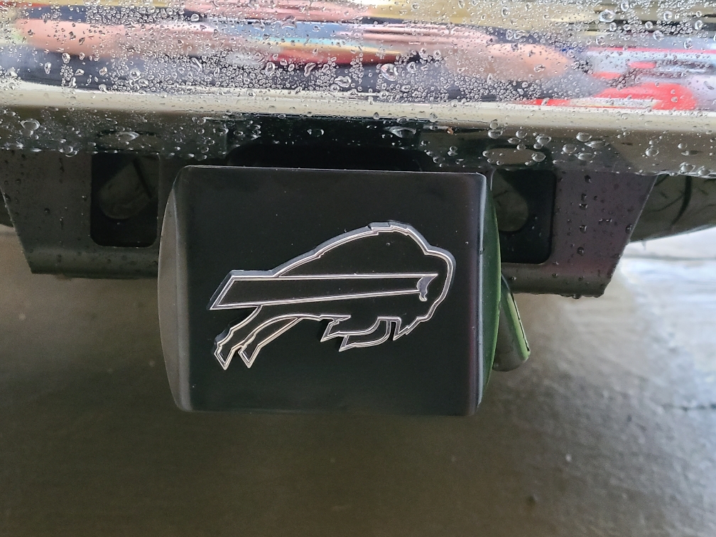

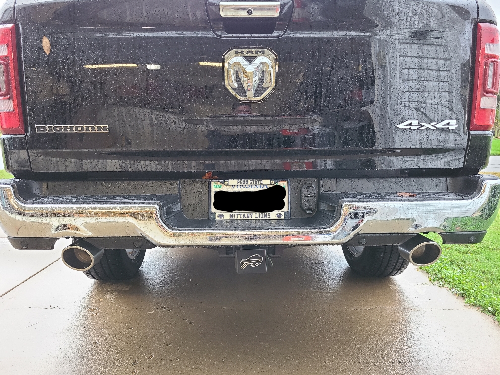

My new hitch cover came in today. Let's go Buffalo!!
