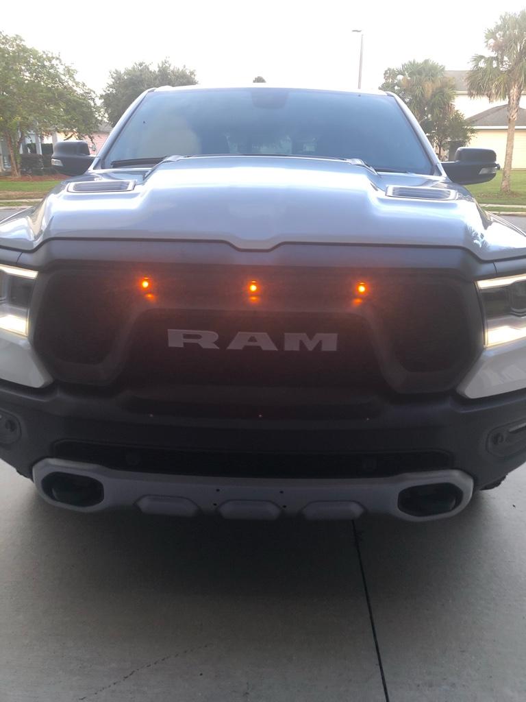

Used fuse f60, turns on with ignition. Works great grounded to on of the grounds next to fuse box on the fender.

Used 11mm lights from oznium and the surrounds holding them in place are actually drilled out 5/8 rubber feet from ace, looks damn near stock to me.
Close up lights will be amber once my fuse taps arrives.

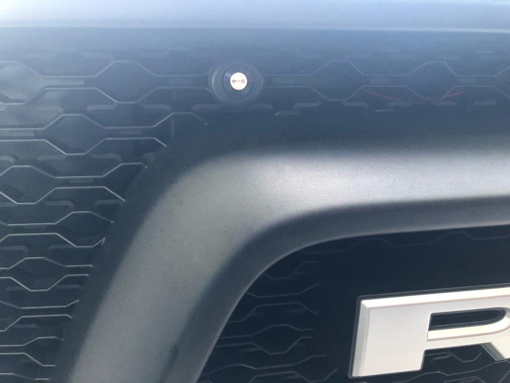

I used these on my gmc, those things are crazy bright for their size and hide very well! Can you provide a better picture of a single light close up so we can see the mount?

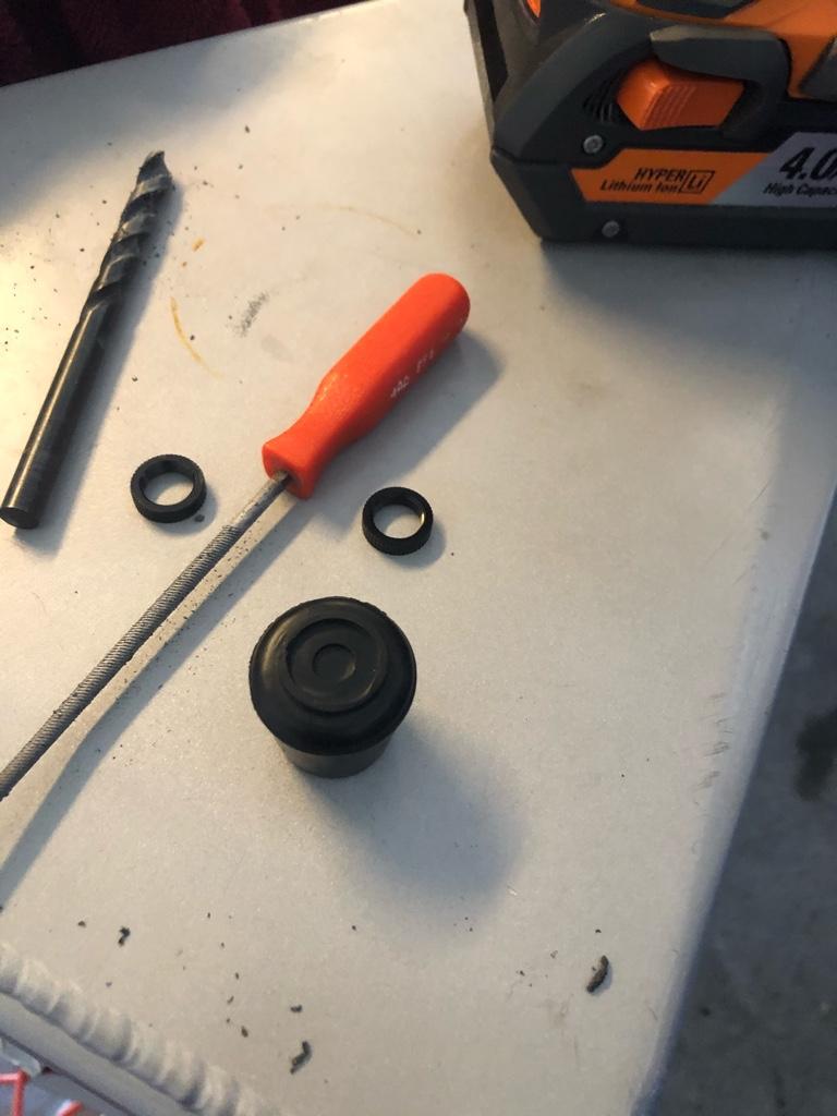

This is one of the rubber feet I drilled out to make the spacer. Just drilled it out and filed just enough I could force the light into the hole. Then just squeezed the rubber into the grill hole. It’s tight, very hard to pull out, was going to add some adhesive but I really don’t think it’s needed. I like how it turned out looks real close to stock. I watched your YouTube in the light bar that’s going to be my next mod though I’m going to use a cheaper controller and sync it to the garage door opener. If you need a closer pick i can grab one in the morning and PM you.
