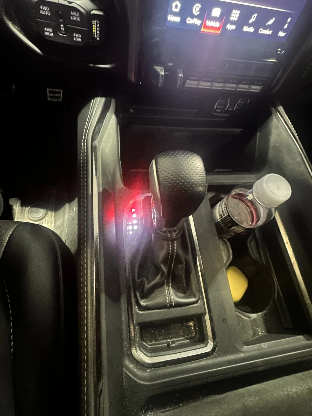

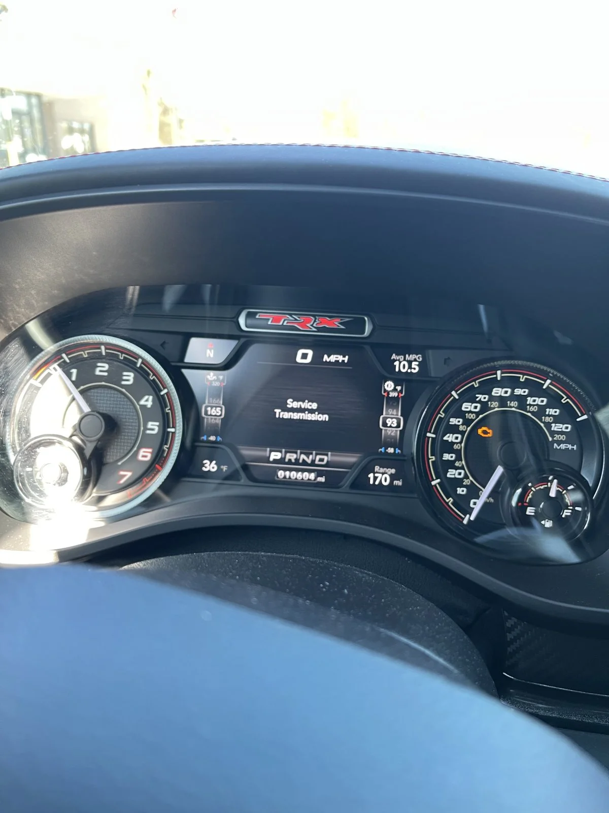

Had no trouble driving through the snow whatsoever however on the way home, I got a check engine light stating service transmission and shift to Park however I couldnt shift to park and once stopped the truck would shut off (engine) itself but would not turn completely off.
I got it restarted and drove the last couple of miles home and looked at it in my driveway.
The ignition still would not go to the off position, only accessory and run which if left on would simply drain the battery. I ultimately had to disconnect the battery and set the emergency brake to get the truck to completely power down.
In doing some digging, I found that this is a common issue with these trucks with heavy snow or wet snow which is what we got.
Check engine light is still on and called a dealer. Told him about the snow and he said ya we have had 8 of these come in with this in last snow. Always a few that have this happen but with the more snow this yr it's been a common thing. You need to thaw it out he said which I did. He said there is a cable that shifts the tranny that builds up with ice. If you need the vehicle and don't have a warm place to put it you can crawl under there and chip the ice away. Nice !! Something every owner wants to do lol. They should put a master switch in these so you don't have to remove the battery cable in -35 to be able to drive it in the winter. Just flip the switch off for 30 seconds to remove the ground to the computer so you can be on your way lol. Or better yet put a shield on the shift mechanism that allows the tranny heat to keep this area dry and free of snow.

So if you drive in heavy wet snow and get enough packed in under the truck, you may get a "Service Transmission" error and a failure of the ability to shift into park
