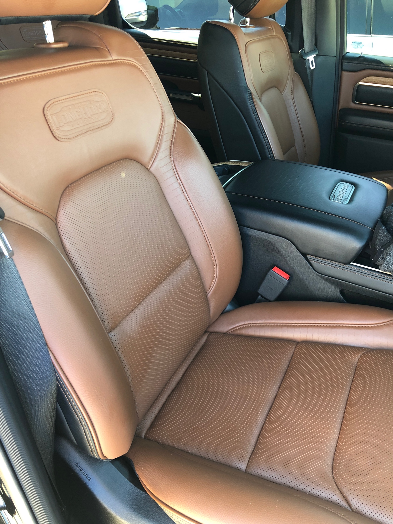

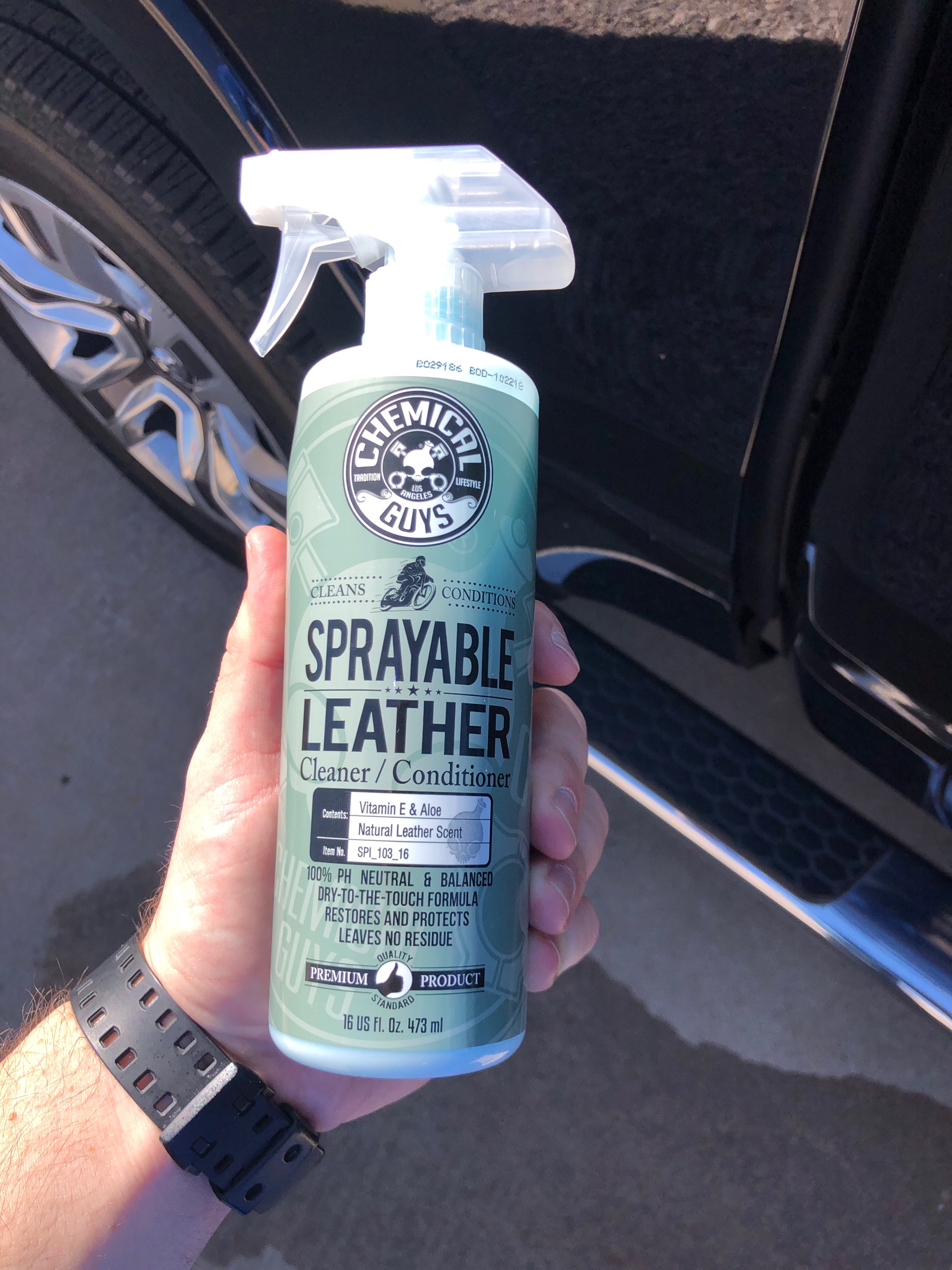

Used this new to me chemical guys 2-1 leather cleaner and conditioner
Love the stuff
