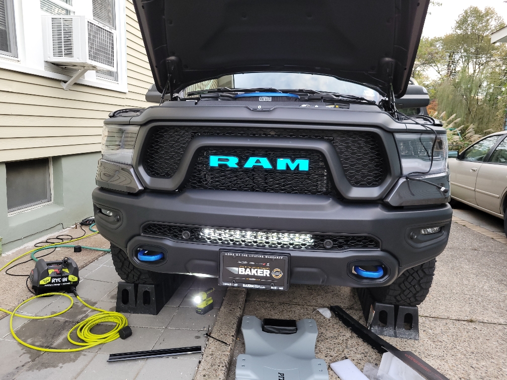

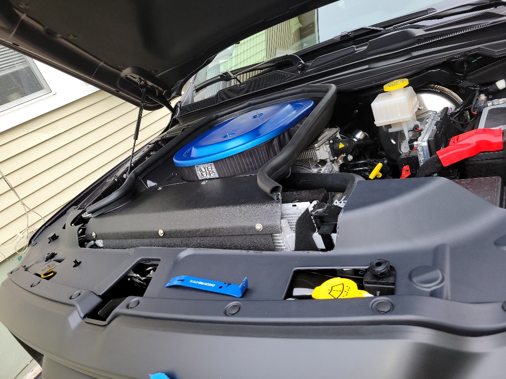

Did some more work today on the ram.
So since I have the vararam Cai, I didn't want to cut some of the oem trim for the plastic cover over the radiator. Found and ordered a replacement ($45) and took the factory one off, and cut into the one I ordered. Looks good.
Then finally, some lighting in the bumper..lol.
