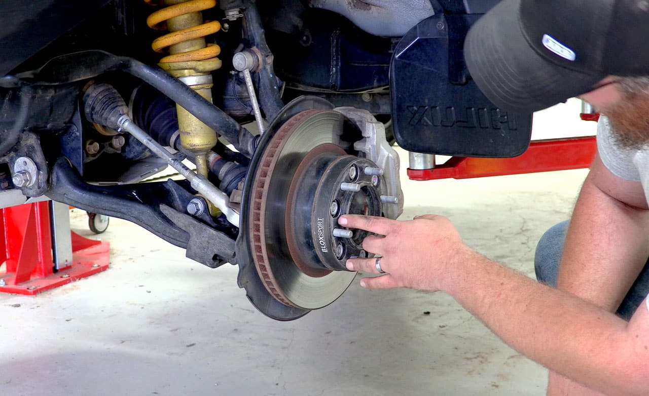

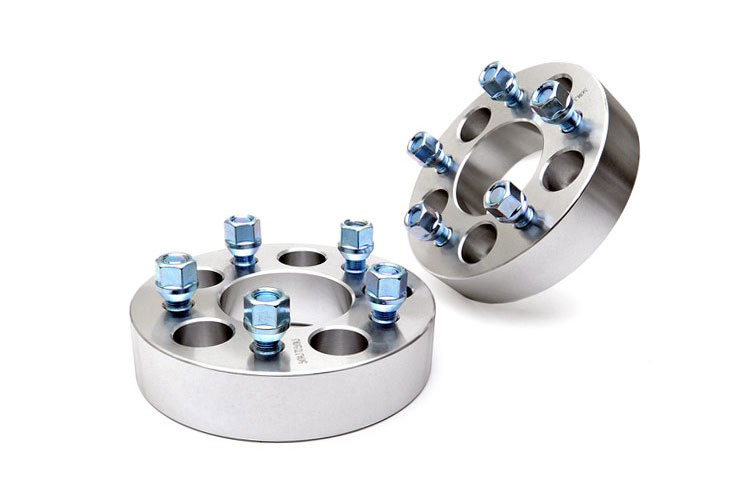

What i meant was i dont know sizes/brands of spacers are good
or which are crap.
It really doesn’t matter at the 1/2” size you mention. As long as it’s just an open spacer like the first image below and not a type like the second image below, then you don’t need to worry too much about the brand. My one recommendation though if you get the type like in the first picture is to get hubcentric spacers- It will make your life much easier when you’re mounting the wheels
Note: towing with wheel spacers is not a good idea, although people do it all the time.
Why is towing with spacers bad?
i have not towed a trailer in years, but…
The 2nd spacer may not be a tow weight rated spacer, studs make sheer off. The 1st I don't think would be an issue, I'd be concerned about increased wheel bearing wear with the 2nd though as you're changing the way the and where the load is carried on the bearing
The farther the wheel moves away from the hub, the greater sheer stress is placed on the wheel studs. This could cause failure of the wheel studs. It’s not normally a problem under normal conditions, but can be an issue under extreme stress situations like drag racing or towing with maximal loads.
For the type in the second image, there are two additional potential failure points compared to the spacers in the first image.
Edit: those articles Bowdown posted probably do a better job explaining than me.

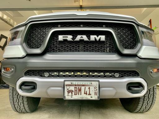

Finally finished up my Shifts and Grins light bracket and Diode Dynamics light bar install.
Sorry for the rain in the end, filmed in between tornado warnings. Overall, I’m super happy with this combo.
