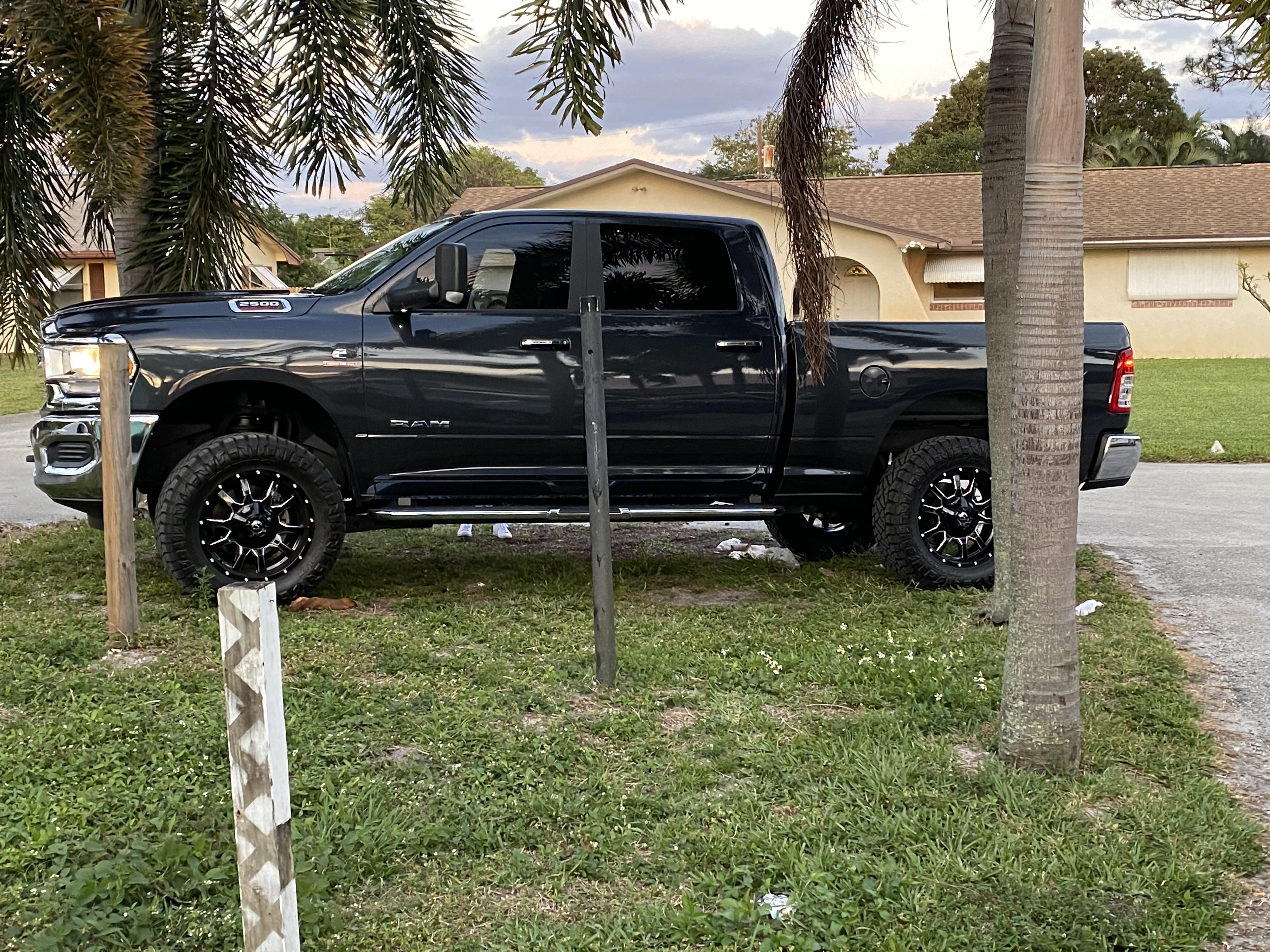

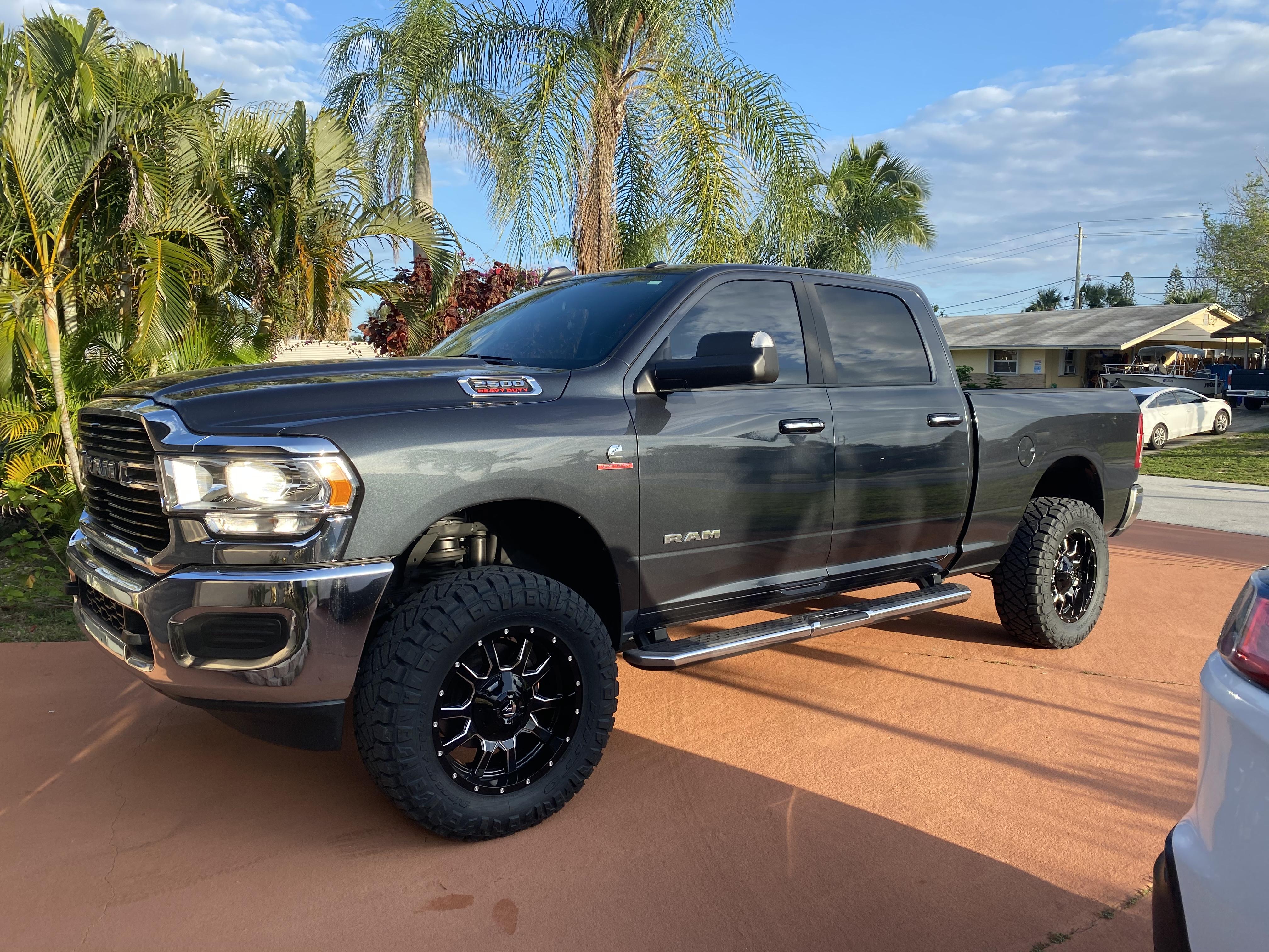

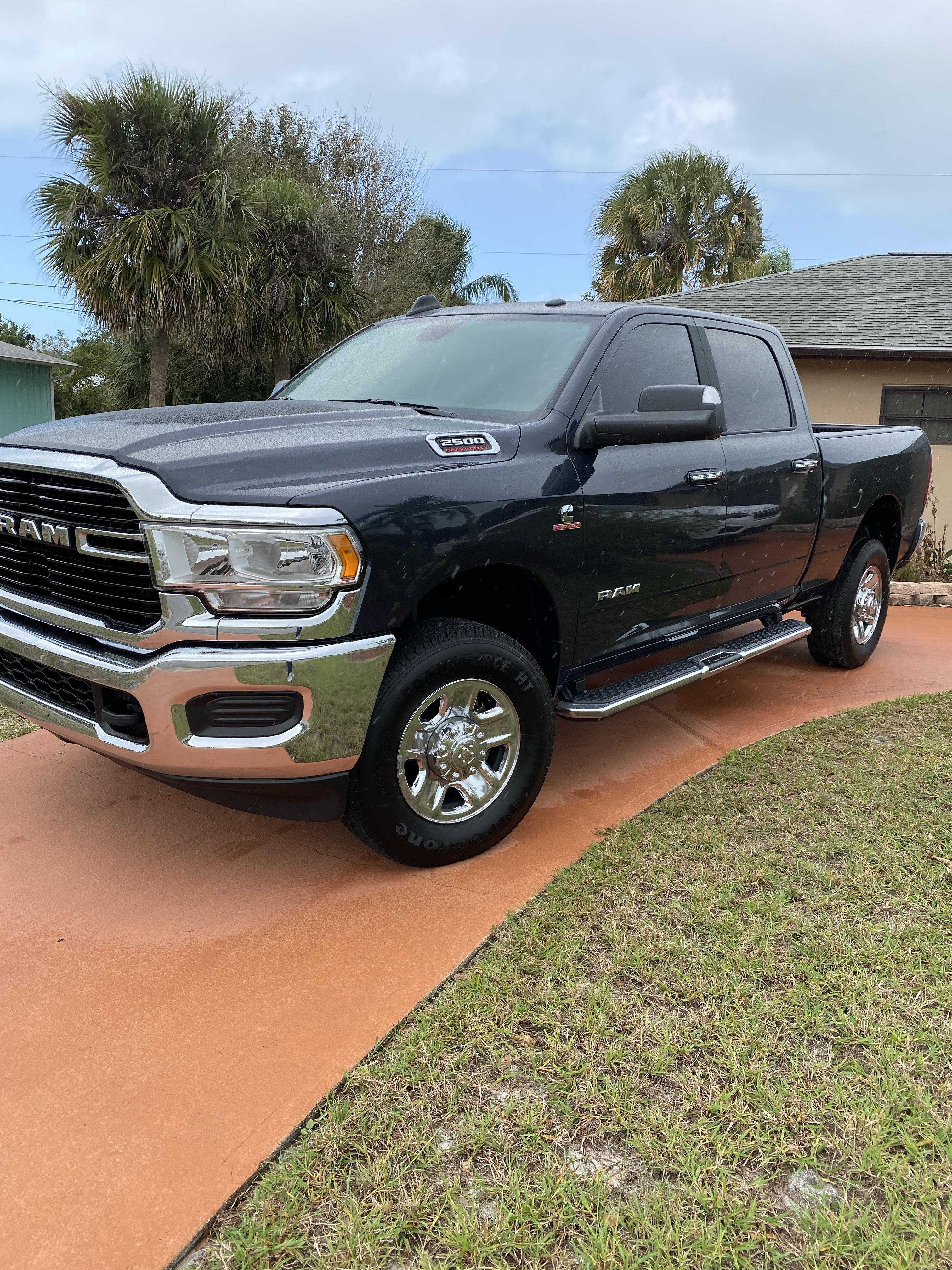

I just had a level kit installed on my 2019 longhorn 2500 and put new tires and wheels and was shocked how much taller it was.
That’s a before and now the after.
I’m also thinking about installing air suspension due to the fact that I have a 5th that I pull behind so when not hauling i would like to have like 4 or 6 inch lift but lower when I have to tow. Can anyone tell me if this is possible and recommend an air suspension that they are happy with and works well
