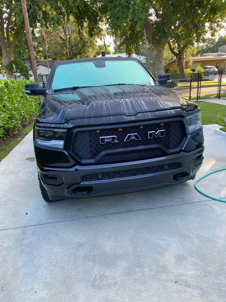

This is on my big horn it fit perfect no modification at all
Looks great. Was hoping someone would have a black one with the color matches front end. I may do this to mine now. Should complement my lift nicely.
That looks so good! Wish it fit the Rebel that well
Thanks i think it’s the bumper area on rebel that doesn’t let it fit right
