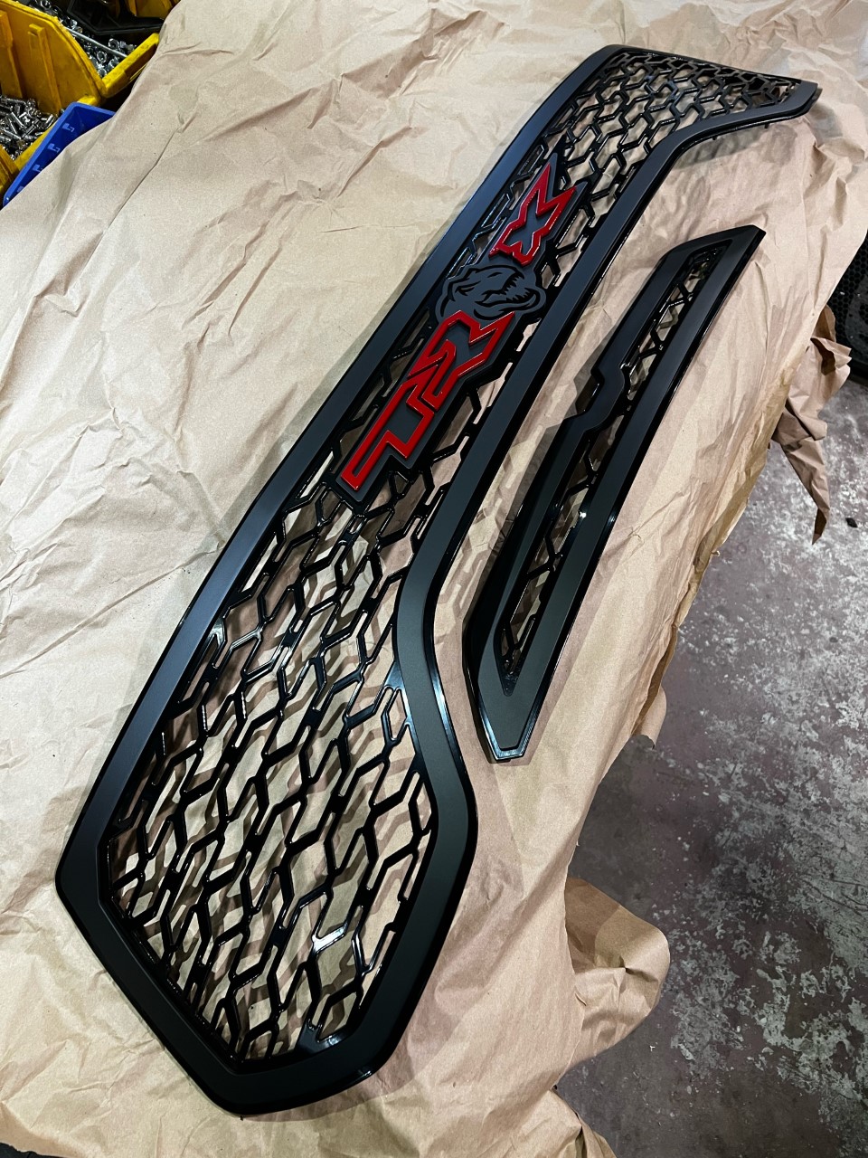

After I put several clear coats on the letters and let them dry good. I mounted them with the tape and let them sit over night. They seem like they are on pretty secure. I crossed my fingers yesterday when I took it to my car wash that they would still be on when I came out the other side and all was fine. It’s not a bad grill. Definitely not as robust as the factory grill though. But I think it will last. If it doesn’t, I can try another one without the letters and and lights or go back to factory.
For the lights, I used a fuse tap and went into fuse 60 in the engine bay fuse panel. RAM Patriot recommended that in another thread. That fuse comes on with the truck ignition in the “run” position so it works perfect to have the lights come on with my DRLs. Also easy to remove. Just pull the tap and put the fuse back in.
