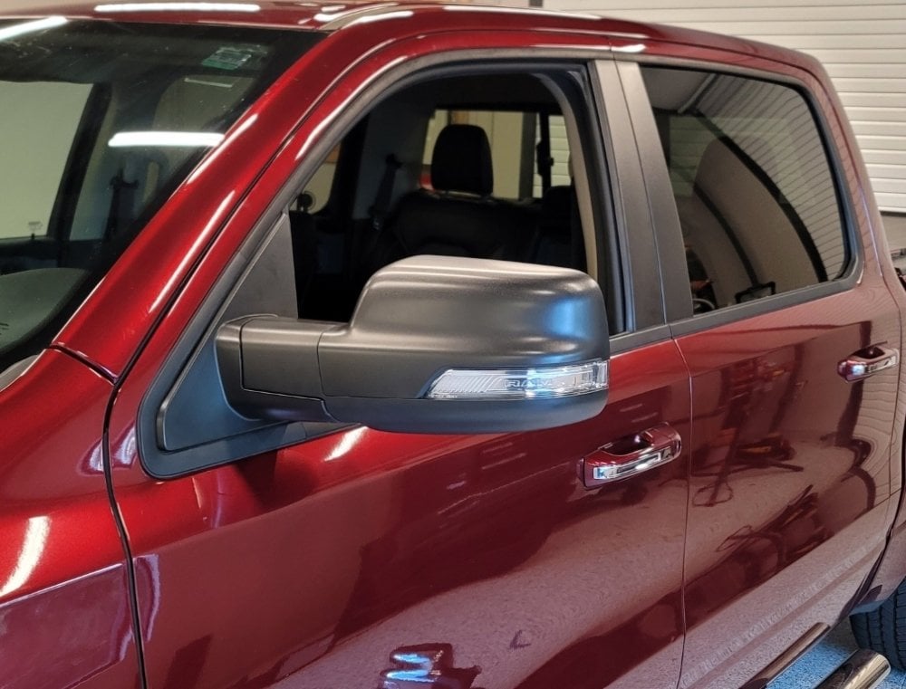

I just tried to fold in my mirrors for the first time Today before going into a car wash and low and behold...there is no power-fold button. I have had my 2020 Ram Rebel for one week and just found out about this poor window sticker debacle. My Level 2 clearly states Power Folding Mirrors. And there is no heat either; drove home tonight from a friends house and both mirrors are frosted over. I will be calling the dealer tomorrow. This is not right! I paid for this option.

No it doesn’t.
Ok. Well then I think that would mean u don’t have the folding mirrors but kinda weird since it’s listed on ur window sticker if I’m remember ur post correctly. Maybe it was deleted or replaced under the optional equipment section of the window sticker. Also, are your exterior mirror housings body color or black plastic? In researching my Ram I remember seeing many body colored housings being power folding.
The optional package of trailer tow mirrors remove the standard power fold mirrors.
Tow mirrors DO NOT powerfold.
Also removing surround view.
Also removing heat on tradesman, big horn, and rebel.
Dealerships need to learn this, tell everyone this disclaimer, and RAM needs to decide to change this or not offer the tow mirrors at all on 1500.
It has been 2 years now that we have been explaining this.
