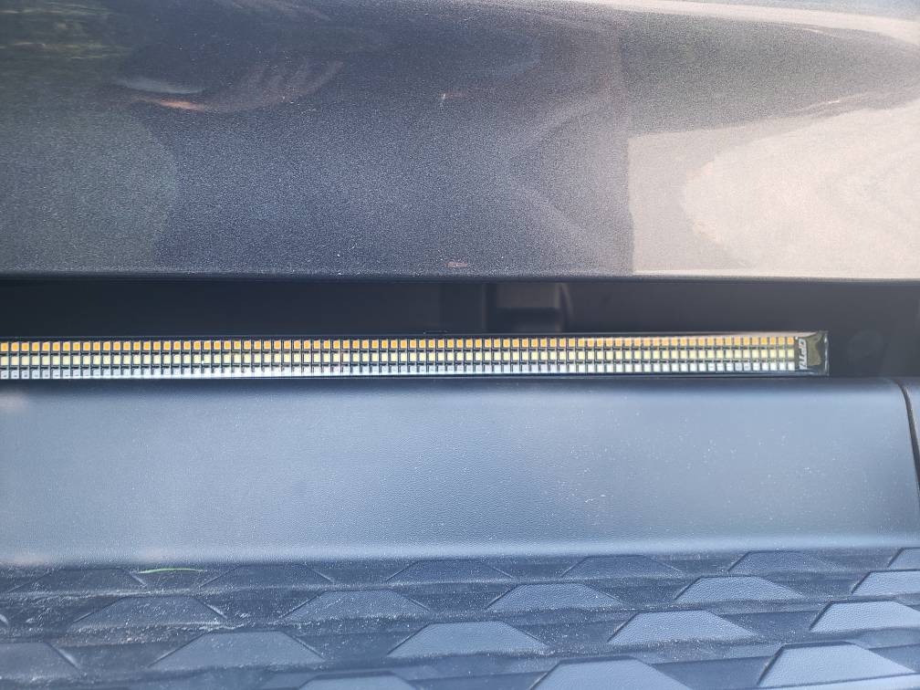

Installed the triple redline with Curt 5 way harness today much like the previous account. I'll add a few small details. Used gardening shears to cut through plastic housing on extra provided pigtail from the lightbar to isolate the extra bullet. Wire nutted that wire end to the white wire on the lightbar and plugged into the last opening on the connector. Worked perfectly. Actual install time was probably about half an hour. Measuring and remeasuring screws placement took as long if not longer, but I was pretty ocd. Glad I took the time though. I ran a thin piece of metal across the top of the bumper to lightly score a guideline across the black plastic for clip placement. The clearance can't be more than a few millimeters. Aligned lip of bar itself just below bumper edge with bottom of lowest row of LEDs flush to top of bumper. #4 1 inch screws. 1/2" by 3/8 diameter nylon spacers for the middle clips, 1/4" by 3/8 diameter nylon spacers on the outside clips. Here's a few pictures.

Installed the triple redline with Curt 5 way harness today much like the previous account. I'll add a few small details. Used gardening shears to cut through plastic housing on extra provided pigtail from the lightbar to isolate the extra bullet. Wire nutted that wire end to the white wire on the lightbar and plugged into the lay opening on the connector. Worked perfectly. Actual install time was probably about half an hour. Measuring and remeasuring screws placement took as long if not longer, but I was pretty ocd. Glad I took the time though. I ran a thin piece of metal across the top of the bumper to lightly score a guideline across the black plastic for clip placement. The clearance can't be more than a few millimeters. Aligned lip of bar itself just below bumper edge with bottom of lowest row of LEDs flush to top of bumper. #4 1 inch screws. 1/2" by 3/8 diameter nylon spacers for the middle clips, 1/4" by 3/8 diameter nylon spacers on the outside clips. Here's a few pictures

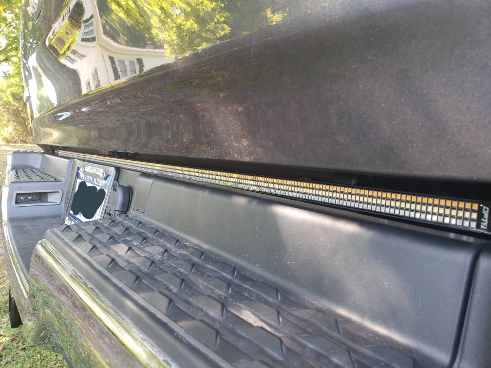

Did not hard wire so I have a one blink delay on turn signals and hazards. Thought it would bother me, but haven't thought once about it since installing. Here's a close up of the install for orientation/spacing on bumper if anyone is needing.

Super abbreviated install here with a few pics ( all attached )
I went with the OPT7 Triple light bar. You need to mount it just above the bumper or the tailgate will hit it when it opens. You also need to use the metal brackets and spacers ( I used stainless washers form home depot ) to attach it in order to clear the wiring for the tailgate and camera. If you don't have that wiring harness then you wouldn't need to do that.
I used the Curt 5 way harness to attach the light to the towing harness. Curt part # 56584.
I then used a hopkins 5 way connector kit to make my own harness to the light bar. IMG_154
I used both ends of the connector kit and connected them together. IMG_150
I used a male bullet connector and connected it to the white wire from the LED bar for the reverse lights. IMG_157
I can use then that bullet connector to connect to the harness I made using the trailer connector kit. You can get the idea from IMG_147
With all of that said I took one end of the connector, attached it to the light bar connector, attached the bullet connector and taped it all together. IMG_158
Then you simply have to use the other end of the harness to plug into the curt connector. All Done. I know you can do this A LOT simpler but I wanted a way to simply disconnect form the curt harness and take the light bar off if needed. This way nothing is spliced into the truck or connector and I can easily remove it if needed.
No issue with blis, backup sensors or anything else. I will take a video later on and post to youtube. I will add the link to this thread when I get around to that later. Feel free to ask any questions. I know this may not be that clear. Hopefully the attached pics help.

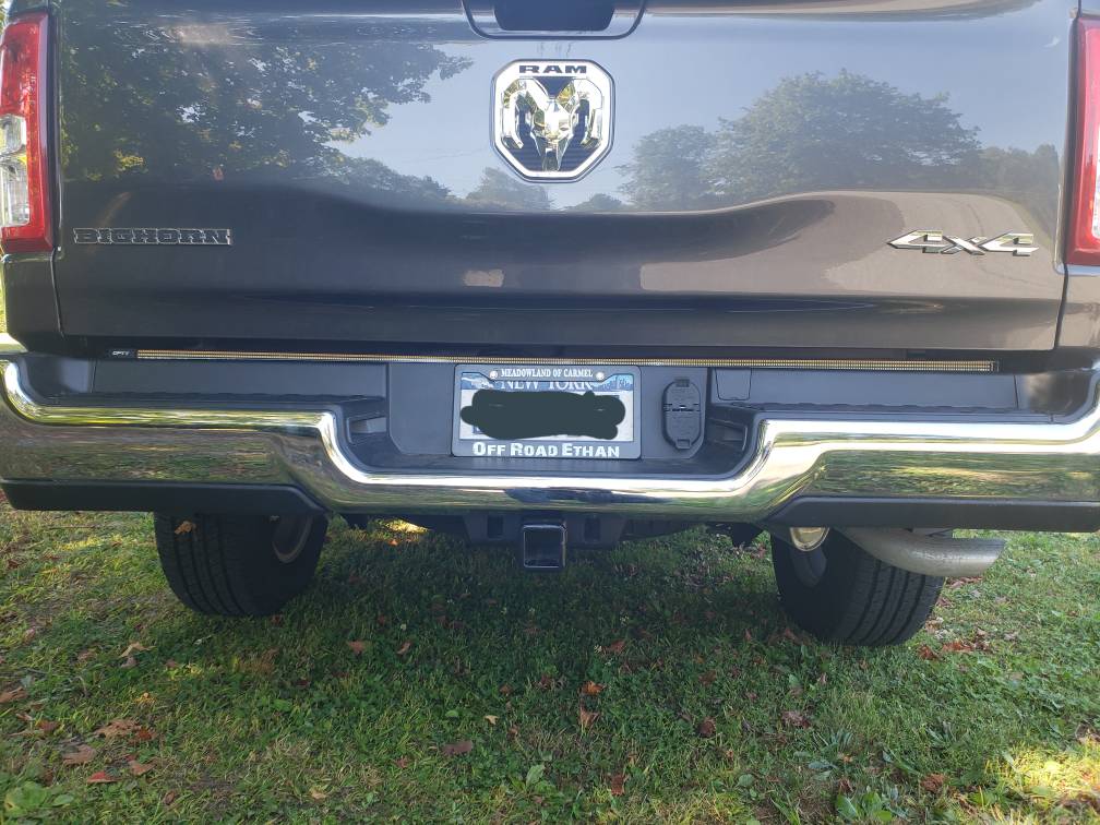

Got my triple mounted today thank you grinch with the back and forth messages to help me. I will get a video up later to show the great function. I might not need aux backup lights now. I used the #4 1" screws and used the 4 stock clips with 1/4" spacers. I mounted 2 clips on both sides of the plastic cover for the tailgate wiring and the other 2 just next to the plastic humps on the strip.

Might be just the picture but it looks a little low in the center.

I was thinking that but I will see tonight in the dark it was as high as I could go without needing larger spacers.

I think it will be ok here is a night shot.
