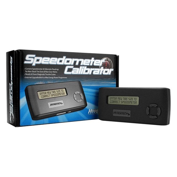

Received my Rough Country to fix the speedometer and all the power warnings scared me off. Can you brick your truck with this thing? Does everyone pull all the extra breakers (GPS, Satellite, etc) like they instruct in the instructions? They say it's as easy as 1, 2, 3, but that opening paragraph sure doesn't make it sound like it.
Let me know how you make out...I was gonna purchase this unit next week after I pt my 35's on
I have hypertech. Works without issue. They make rough country's calabrator. No it won't brick your truck. I've talked to hypertech and it's limited to just calabration. Apparently works with ECM on transmission and shift points. What ever you do don't unplug it while it states programing. It sometimes takes longer than you think. It will eventually say turn ignition off. I thought it was locked up because it sat froze I thought . Unplugged to soon. It screwed programer up. Spent better part of an hour with tech support Recalibrating the The hypertech device.
With the RC speedo tool do I need to unplug all the fuses in the instructions or just do it?
I took my truck to dealer to get re calibrated, they charged me $350. but I keep the calibration tool which is the same one I was going to buy online.
I have 22 / 12.5 / 35's and I entered 33.25 in the tool to have a correct spedo reading.
it's really easy to use.

Hey man, im debating on getting one of the Hypertech calibrators. Can I ask, did you notice a difference from before and after the calibration? I have a 2019 Ram Laramie. I went from 275/55/20's to 295/60/20's with 3.21 gears. The truck definitely feels a bit more sluggish, but not in the way of the power, I feel like the transmission doesn't know what gear to be in at low speeds. Especially if I am going relatively slow (say a yield sign) then hit the gas. It's like it wants to stay in 3rd gear for a while then finally realizes it needs to be in a lower gear and shifts about an hour later.
Long story short, I want to purchase this calibrator, but am afraid it wont do anything. I wanted to get your thoughts on how it felt before/after to you! Thanks buddy!!
I have the same setup. I went with RC calibrator. I can't tell any difference other than the speedometer is correct and the MPG has been corrected.
I've been getting between 13-14 mpg (according to the truck) did yours get better? All things considered, would you do the speedo calibrator again knowing what you know now? Thanks man!
I do more highway driving than town. At this point I'm getting 17ish mpg. Yeah I'd do it again because I'm weird about things being right.
I totally get that. How much was your programmer? Did you have any issues with your car feeling sluggish in lower gears?

14 January 2020 and dealerships still cannot adjust the speedometer through calibration on these trucks. It's a little frustrating considering at first they thought they could do it and were only going to charge me 80 bucks. Now it's looking like I need an expensive tool and have to do it myself... Should I go with the Rough Country or the Hypertech? Do either one of those adjust shift points? I'm just hoping for good answers since I'm kind of waking this old thread back up. I put 275/65r20's on the truck.
Edit: Will the RC or HT also fix the odometer calibration too?
Hypertech will adjust for tire size, Rough country is made by hypertech. The device works as stated. Don't rush the operation. Sometimes it sets programing and you think it is locked up. I made mistake on unplugging. Tech support walks you through the repair. Second if you forget or can't un-marry the unit and the dealer flashes your truck. That will cause you aggravation. Copy of invoice with VIN number listed, sent to tech support. They redo your registration, you reload the software, and start from scratch.
I'm setting at this point. Today, tried software update. No go. Getting error 90. Call tech support. So as easy as it supposed to be be isn't easy.
