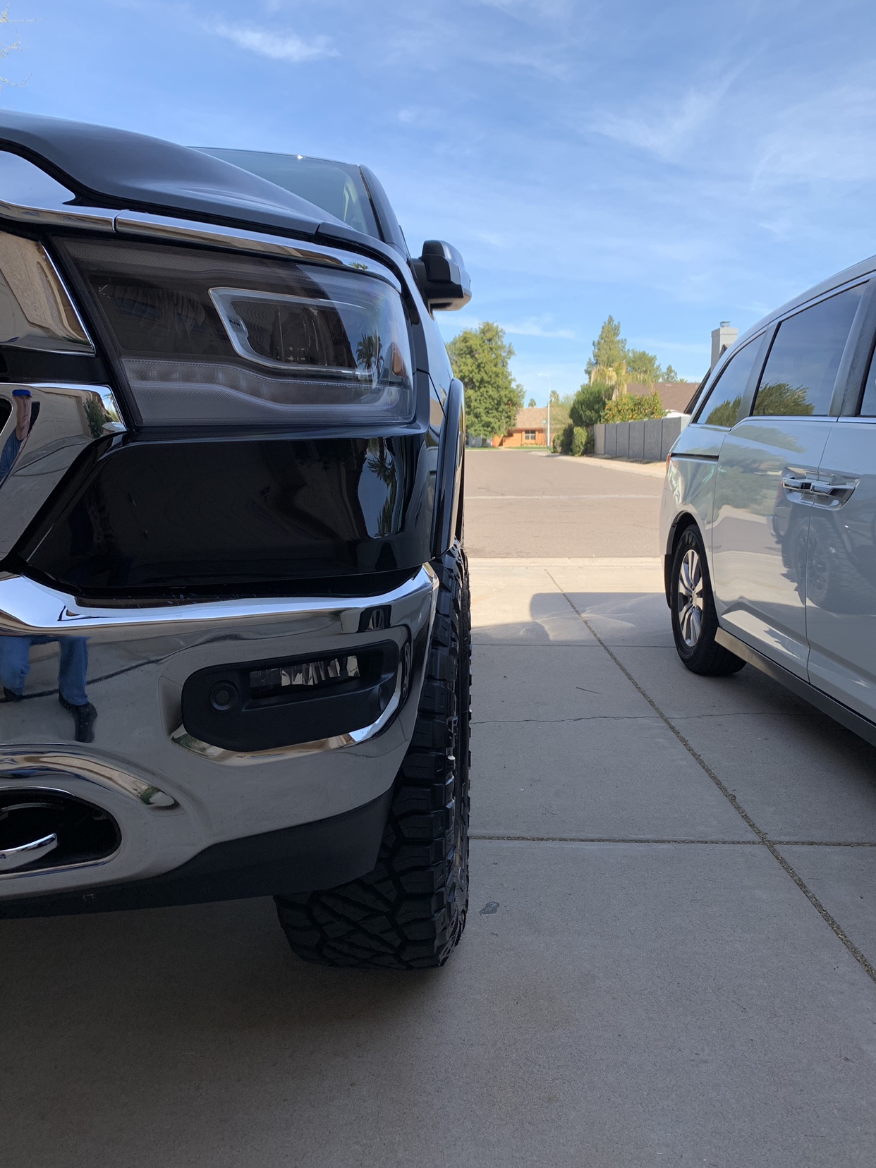

So with that +1 offset your tires stick out around an inch right?
I agree....Thanks for the pic...Mine doesnt have the fender flares so Ill probably roll with theI put on the FlowMaster FlowFX bolt on. No CAI. Maybe a little bit but I really don’t notice it. When I press on the gas there is still plenty of power to get up and go when needed. I really think the topic is way overplayed. I really wouldn’t worry about it.
Maybe around an inch or so. Tried to get a pic but the wheels were a little ****eyed.

Thanks....Did you have rubbing issues? Are you running a 3.21? If so any issues between 7th and 8th gear on the highway? Truck looks great!!!-12 offset here is picture.View attachment 15908
Thanks....what is the recommended PSI? You running Ridge Grapplers?3.21 gear need to trim plastic fender holder at the rear tip of fender and pushed front plastic liner with heat little bit to front. Was not holding 8th gear on Freeway with 36 PSI 14 mpg. Pumped up to 55 all four. No issue with 8th gear any more also getting 18 mpg cruising at 65. Keep in consideration speedometer is not calibrated. Should be +_20mpg in reality.
