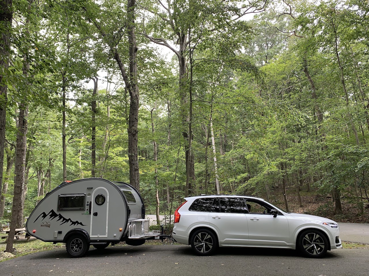

Looks like you put your truck in the dryer, too!Soon to be Ram owner here, but it's always interesting how 'relative' everything is. That 22MLE would be a downright mansion relative to my current 16ft rig that me, my wife, and 3 year old have a blast in! =)
