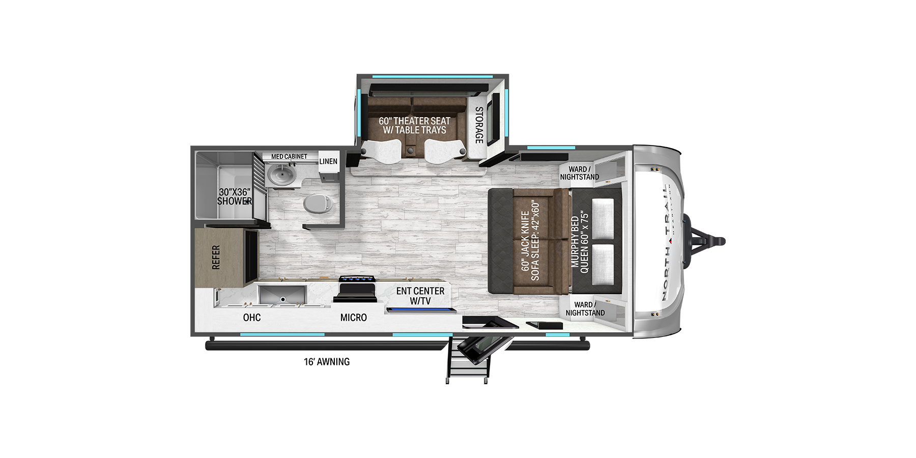

LoNeStAr
Jan 29, 2020
686
516
wife and I are leaning towards this trailer. Shopping for campers is fun :D
We also have the below on the short list
That is a nice one. I noticed the new campers have rhe bed at the tongue. We really want another with the bed at the rear. But guess that isnt the trend right now.
28 foot also seems to be what we will have to go with. Was hoping to get another 26foot...but they sure have made less good use of space.
The numbers look good to. Should be a great fit for your truck.
LoNeStAr
Jan 29, 2020
686
516
There are a few that have them at the rear with a front kitchen but most are on the tongue. I assume that’s to help keep the tongue weight down so people with varying vehicles can tow them.
I didn’t even notice until today, that Passport model is W/D prepped. You don’t see that option in a trailer that size.
I've been looking at the 2400RB as well. We were thinking bunkhouse for grandkids. But the reality is, we'll travel alone as well so when the grandkids are with us, "Grampsy" would sleep on the dinette or a cot. I really like the bathroom set up, it actually has room to change your clothes!
