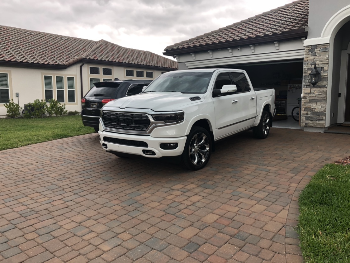

BOOM! SON!! Same here. Suction cup worked as advertised lol! You can go to your local Walmart and buy this suction cup in the link it was about $8.50 it’s a bit scary how hard you have to pull but it works!
Thanks to all the awesome people in this community couldn’t have done it without your help. Here’s some pictures and the link
View attachment 20977View attachment 20978View attachment 20979View attachment 20980View attachment 20981
Are your caps bright white or ivory? I cant seem to find bright white
