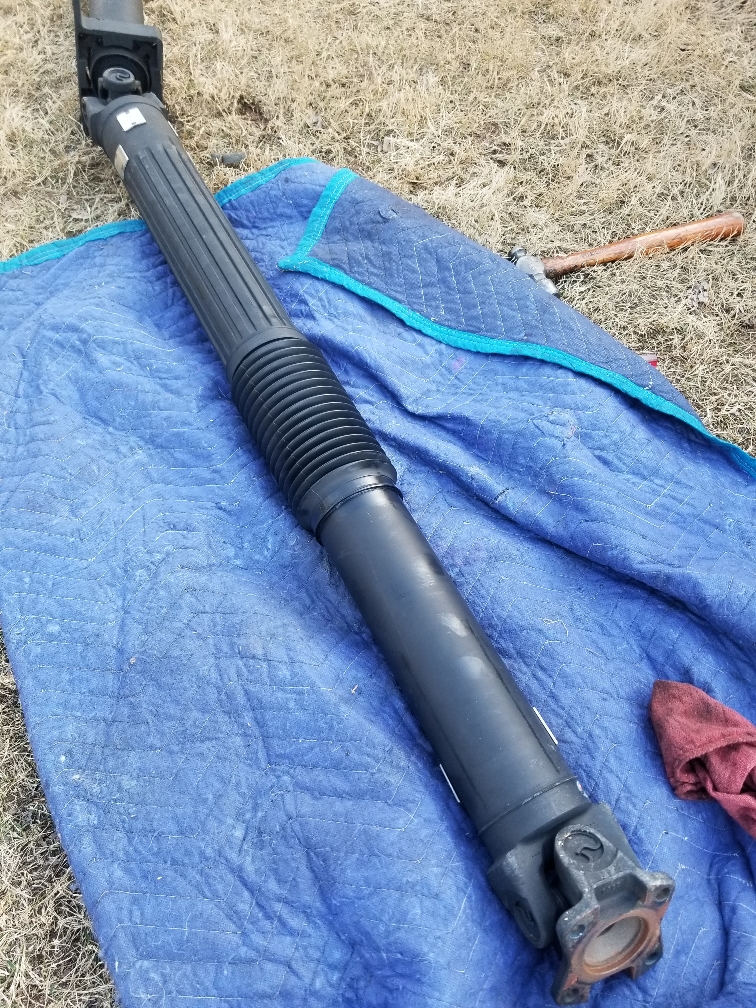

Mystery solved, lack of grease in the odd rear design on the drive shaft. Have to remove drive shaft from rear of truck and add plenty of grease to the area that slides out from the dust cover sleeve. Posted a picture.
Do you have a better picture of where the grease was applied? did that solve the issue with the hard down shifting?

What about this grease fix on the driveshaft? does it actually work?

From my experience, Any tranny programming is good for a few days and then it comes back. I think it's an actual hardware problem and not software. I'm addressing this issue on Friday and will let you know if the Drive shaft grease fix is going to fix it.
Keep us updated. If the TSB doesn’t fix it and I would like to point the dealer in the right direction.
