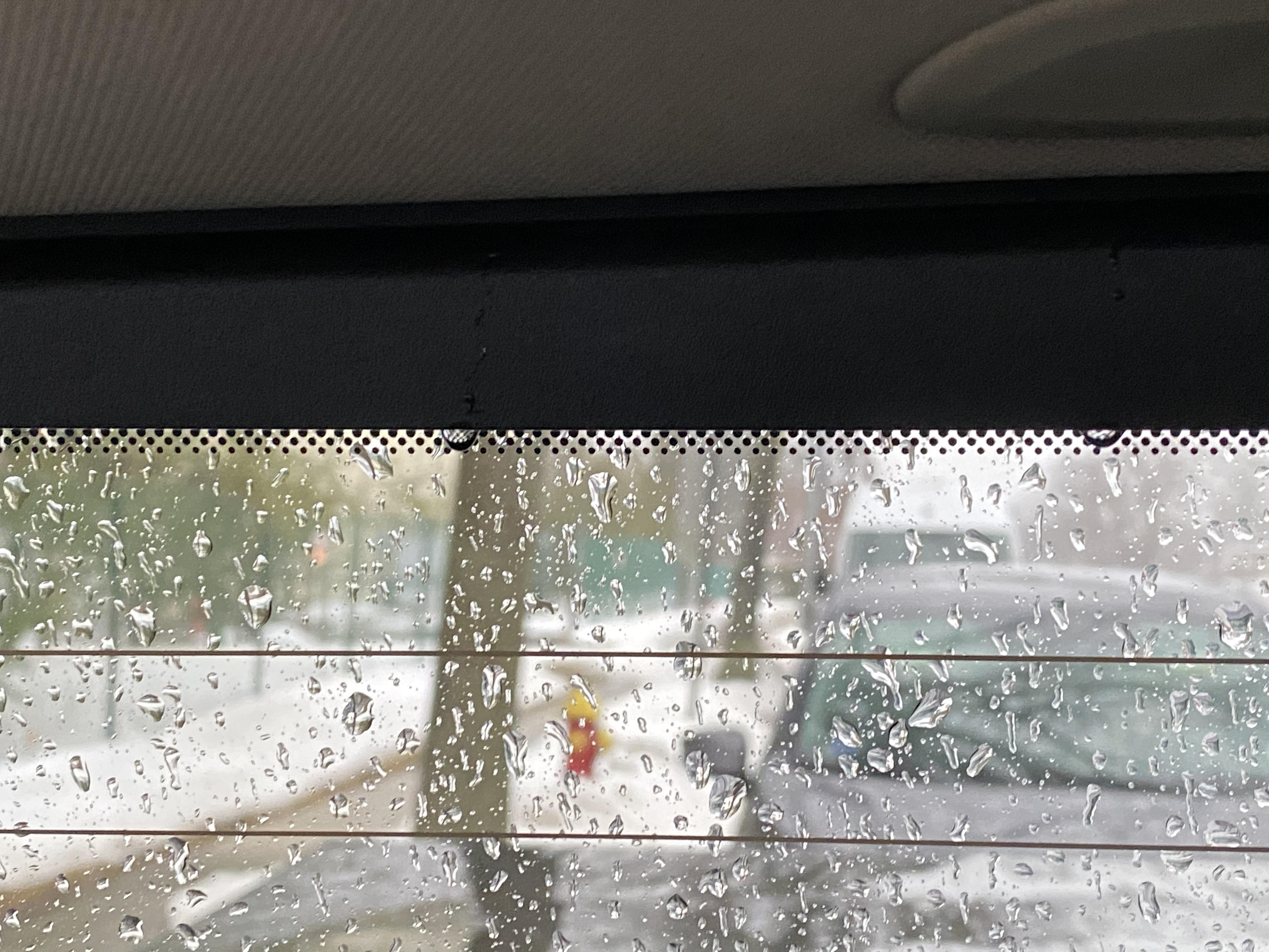

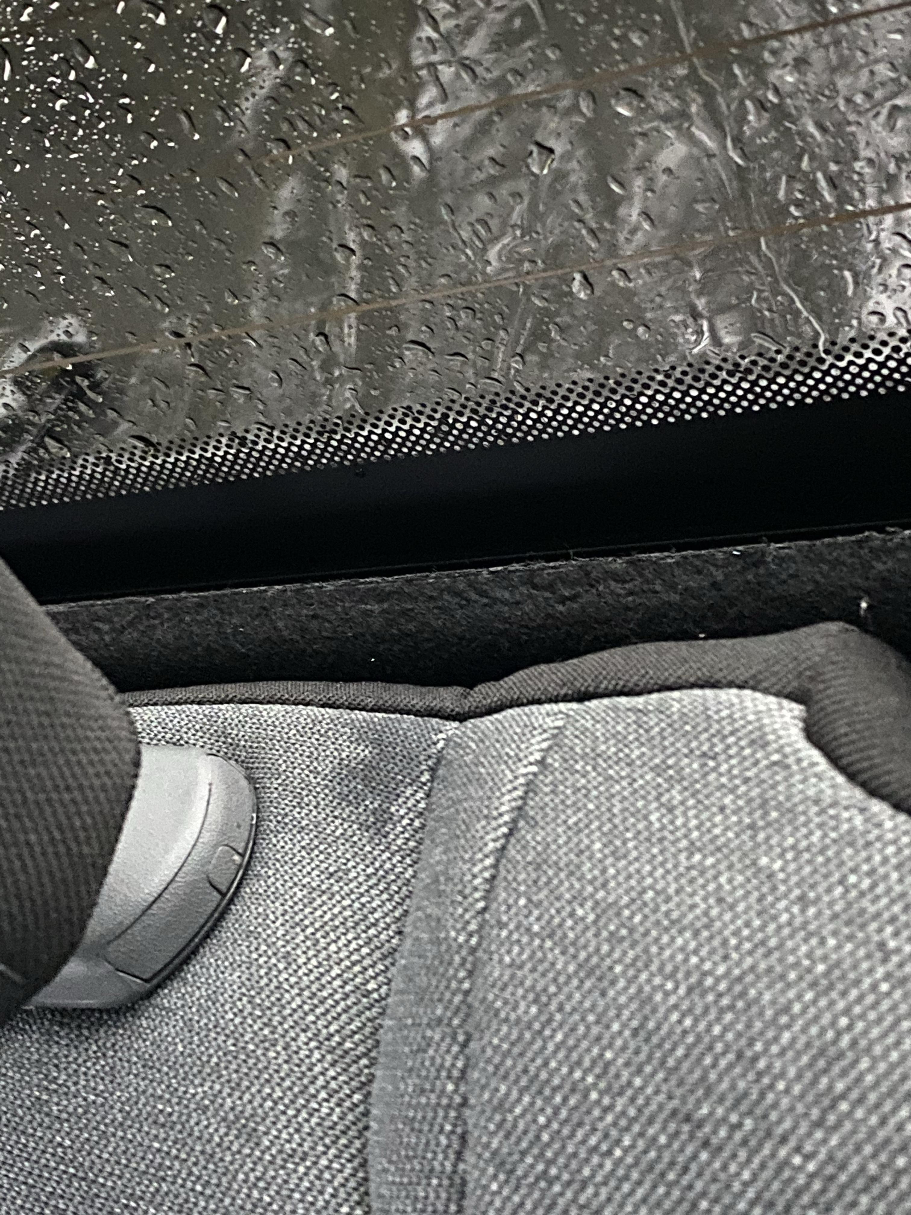

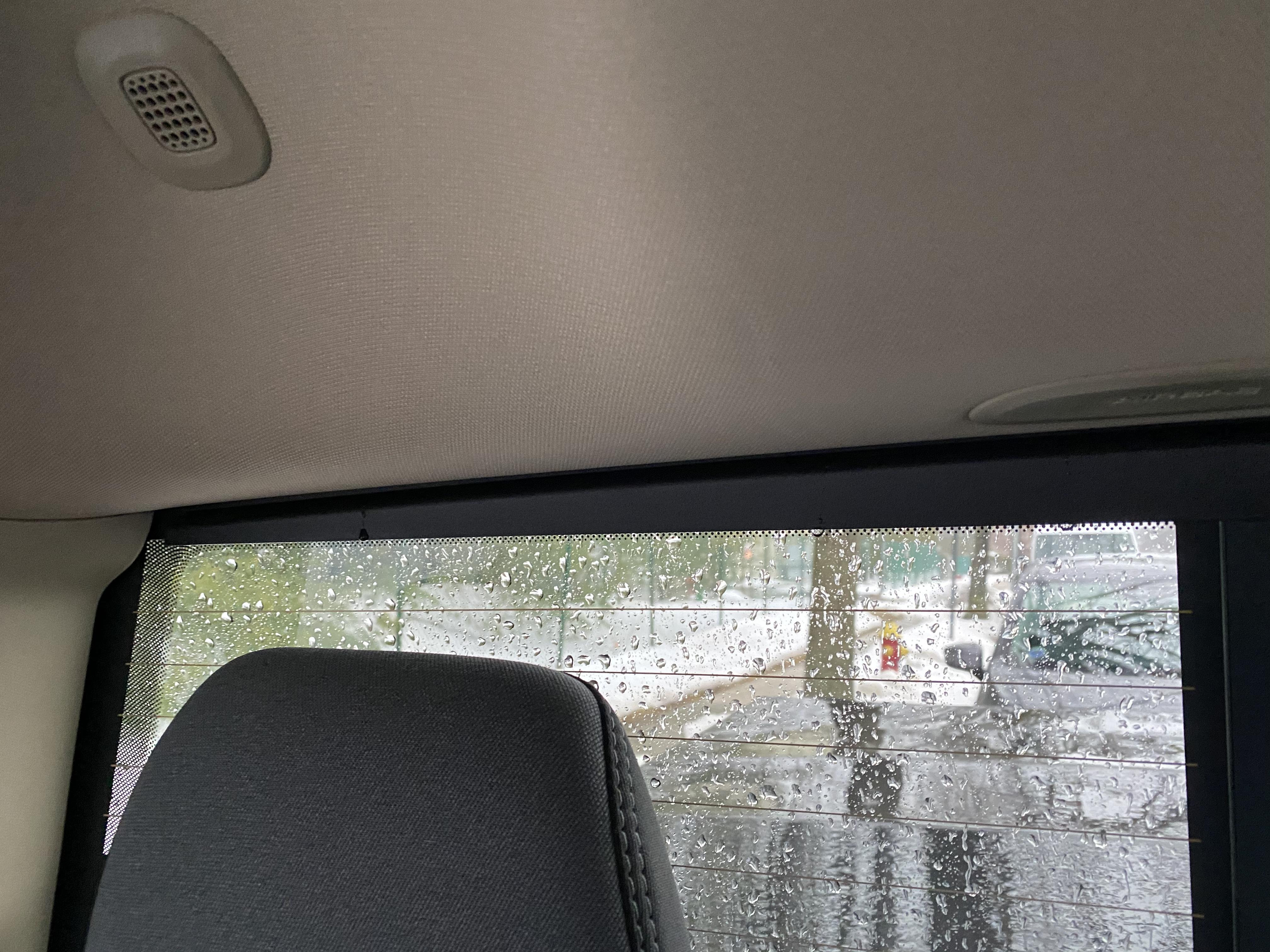

I must have Jinxed myself good with this previous post. My crack started leaking the next day. I identified it to the dealer this morning. Hopefully this second window replacement will solve this issue and it isn't just a new part number without improvements.
Less than 2 weeks after having the window replaced ...3 separate drips
Maybe? Dropping it off again Wednesday morning so we’ll see
The brake light seal is probably shot. It deforms badly and really can’t be reused. I’d check also to see if the brake light screws are tight. But most likely your brake light seal is too compressed to work anymore
That is quite possibly an installation error. Not sealed properly. Be very cautious if they tell you they can seal it. (Didn't work for me) Also, be even more cautious if they tell you they want to remove and reinstall the same window. I was told by a glass guy that that was nearly impossible to do without issue.
