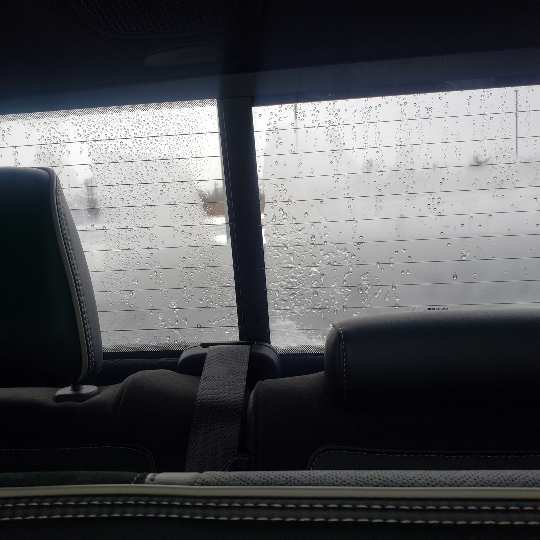

For those that have had their window replaced with a new one, has your new one cracked? Curious if they are slapping in the same part or installing an updated one.
500 miles on ODO, just checked/noticed this weekend. Not leaking, but is cracked on both pillars, bringing it by dealer this afternoon. Build date 07-19, purchased just before Christmas with 24 miles on it. I have only opened and closed the slider window once since purchase.

The dealer knew it was a common issue. Said I wasn't the first with an eye roll. They said that others had come in because of leaks, and the techs found the cracks, luckily I caught mine pre-leaking. She took photos and have to order the replacement, will call when in to be replaced at a local auto glass shop, not there. Once I have it fixed, I will not use the slider at all and will keep an eye on it. Not sure if the cause is the tolerance in the channel and the glass, if it has to do with using the rear defroster and thermal expansion of that area when cold makes it snap or if initial installation is it. Obviously shouldn't be happening, but will deal with it. Otherwise, love the truck....so far.
