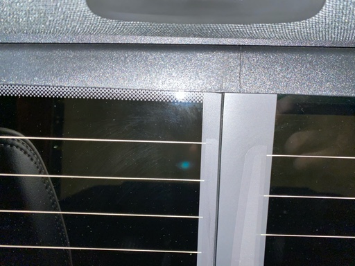

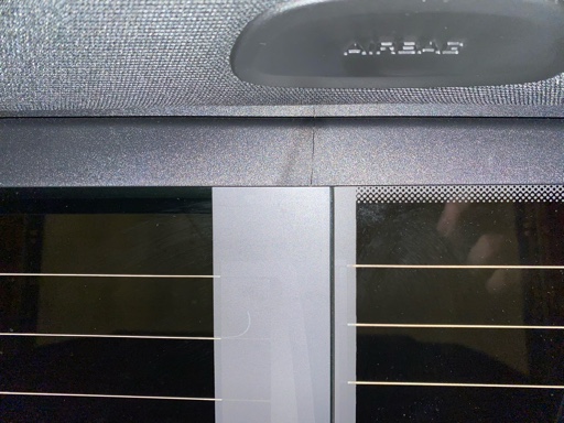

Rear window surround crack.
Dealer confirmed crack/leak, and has to order entire rear window assembly. Had to send pics to Chrysler for approval to order. No ETA.

Got truck back from dealer tonight. Dropped off 8 Nov. Replaced entire rear window. Window shipped from vendor and received in less than 5 days. Local shop contracted by dealer did the install. You can faintly see the mold marks, even on new window. Snapped a pic of label from new window box and warranty repair order.

Crack visible from the outside.
