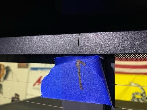

Rear window surround crack.

Due to this manufacturer defect, I also require this surround repair on both sides of rear sliding window at 58,100 miles on 2019 model. Never been in the cold. Little help @RamCares
I joined the club. 2020 Ram 1500, 9,500miles Manufacture date 09/2019. Noticed the crack on the driver side of the rear window and water leaking during this winter season. Brought it to my dealership, they investigated and determined to replace entire rear window assembly and third break light (I guess for good measure). Waiting for parts to come in, possibly end of January. Attached are some pics and part numbers. Video of my leak here:

To sum up my entire situation with getting the back window replaced:
Called into my local dealer and from start of the FCA claim and the window getting installed took one week.
- I had a crack on both sides of the powered sliding back window on the molding as most people here do
- Water slowly dripped in when wet outside or visiting the car wash
- The local dealer outsourced to a local glass shop for the repair
- Repair looks good, nothing I've noticed seems broken or misplaced.
- Mine was totally covered under factory warranty as the truck is only 2 years old. 30,000 km.
- Window assembly was replaced with "68426398-AC"
It has now been roughly a week, no cracks or water leaking inside cab at this point. Washed it today and all seems good. I will update as time goes on for long term effect.
