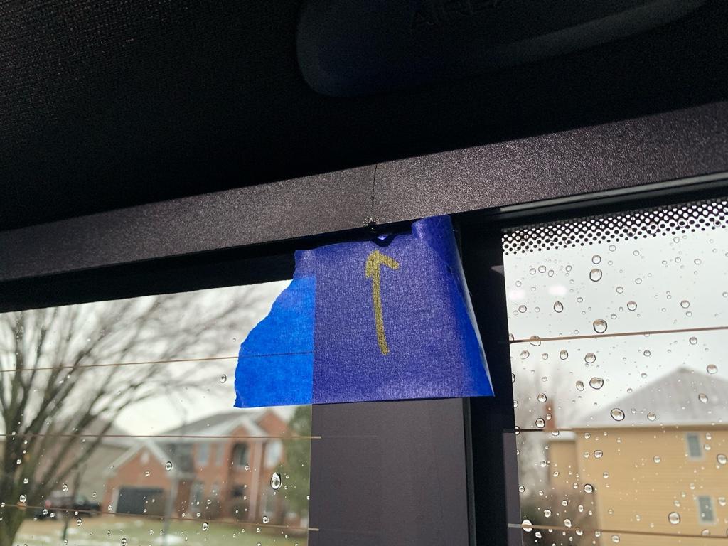

Due to this manufacturer defect, I also require this surround repair on both sides of rear sliding window at 58,100 miles on 2019 model. Never been in the cold. Little help @RamCares IMG_9129.jpg

I joined the club. 2020 Ram 1500, 9,500miles Manufacture date 09/2019. Noticed the crack on the driver side of the rear window and water leaking during this winter season. Brought it to my dealership, they investigated and determined to replace entire rear window assembly and third break light (I guess for good measure). Waiting for parts to come in, possibly end of January. Attached are some pics and part numbers. Video of my leak here:
