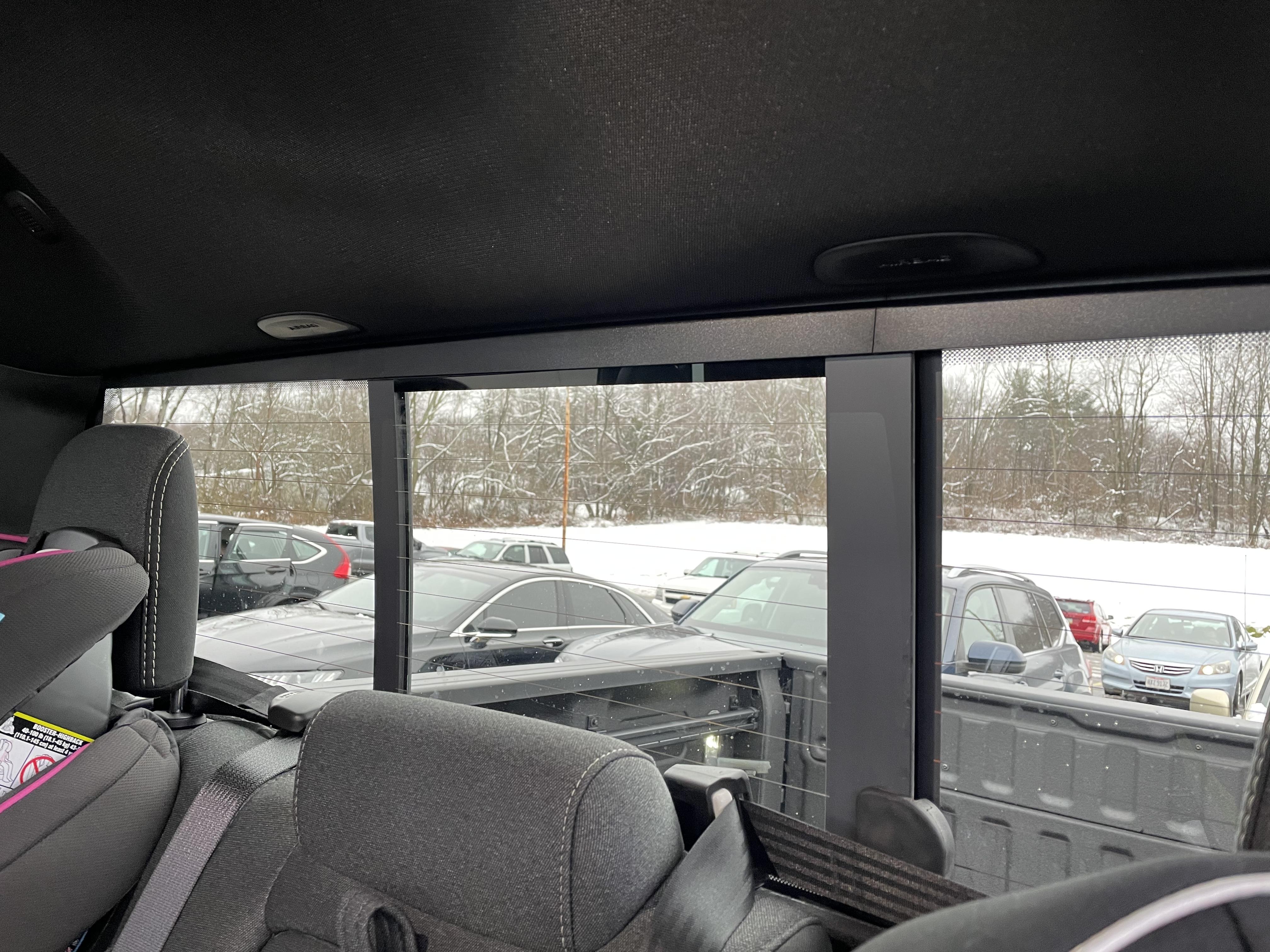

Just picked mine up from getting the window replaced today. The window arrived at the dealer roughly 40 days after the claim was approved and only a few days after reaching out to Mark and RamCares (thanks for the help there guys!). Install looks good. They did remove and reinstall the rear seat. I’m going to double check the seatbelts tomorrow after reading the other posts. I forgot to take a picture of the numbers on the old one to compare. They also replaced my floor mat with a new style for the recall, better than the cutting solution!

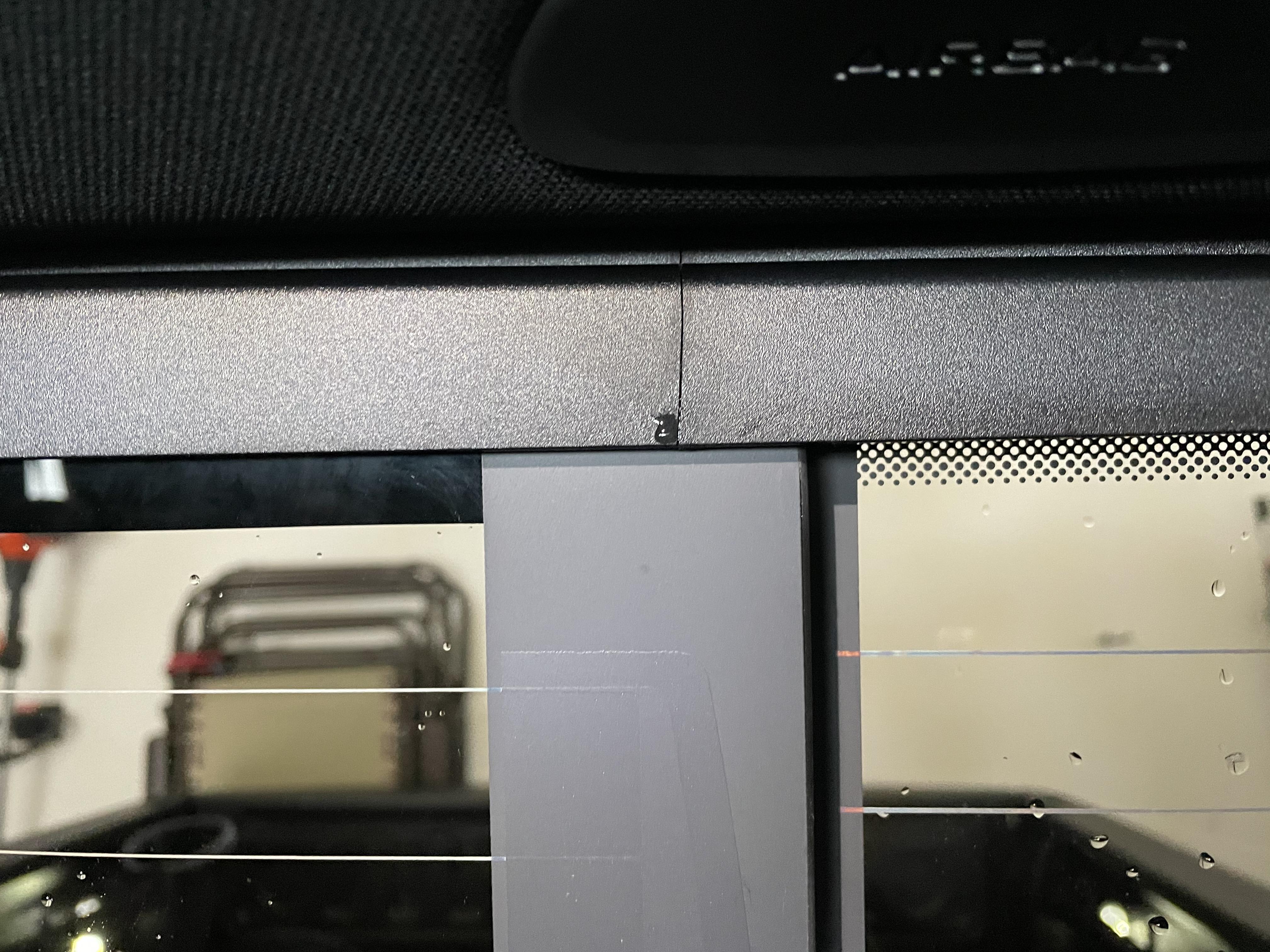

So unfortunately I get to join this illustrious club of cracked rear window liners with the slightest leak starting.
Heading to the dealership today with the pics and star case to see what they’ll do to help

Well I got my truck back from the dealer today, I had no visible cracks in the rear window surround/frame but the tech from LeakPro who fixed my leaks found a few long with a leaky third brake light seal and he resealed the urethane in the corners.

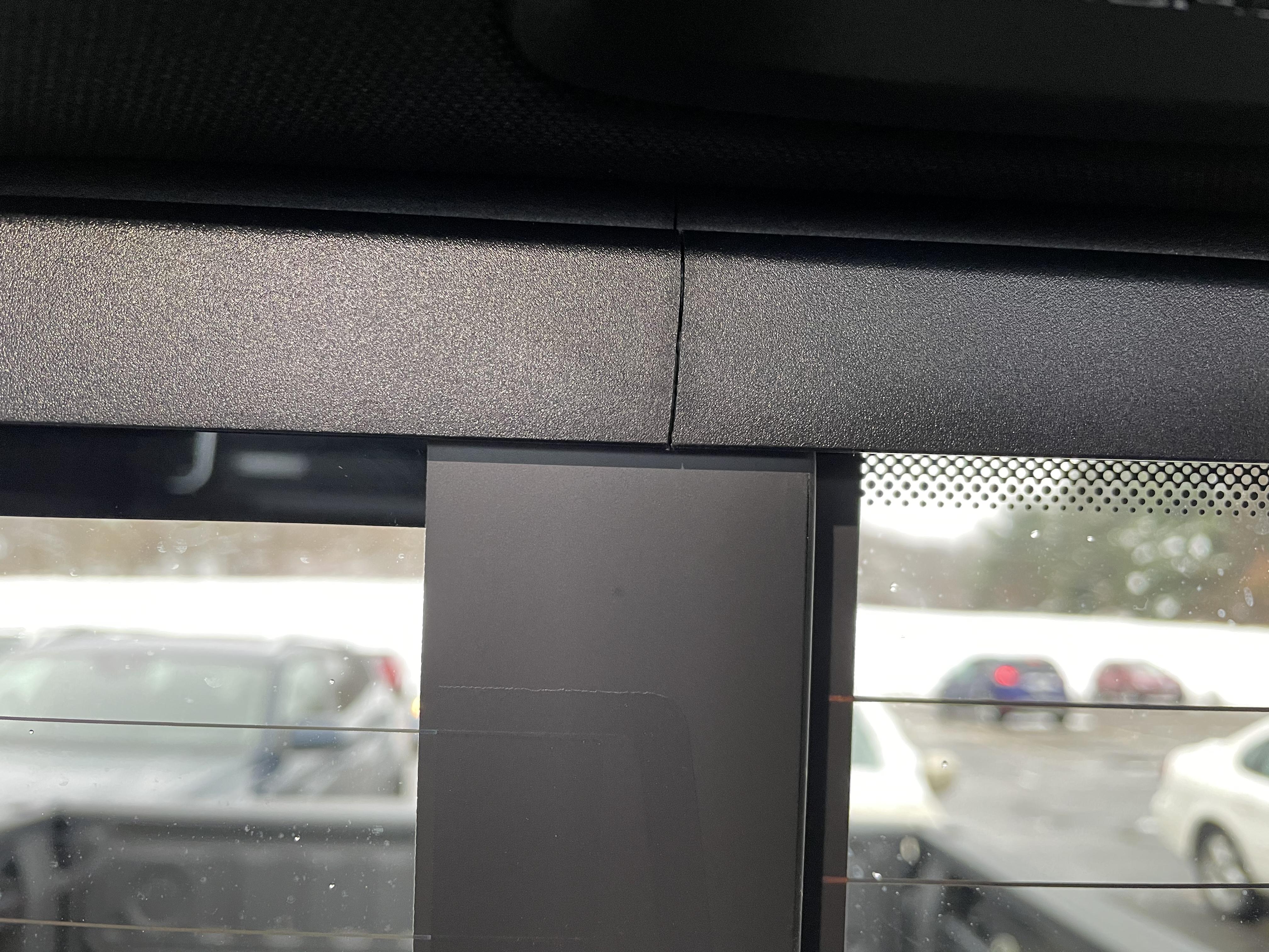

Add me to the rear window leak club. I had the upper brake light leak months ago and I used a better gasket which worked but now I have water coming from between the glass and frame. I have the cracks starting that everyone is mentioning. This sucks.

After a wash the other day I noticed a crack on each side for me. Sure enough, water slowly dripping down inside the cab. Called the local dealer to book it in, told him over the phone what was going on and he said they had their first one of these incidents just a couple of weeks ago. Appointment is in 2 weeks and they said they just need it for the day. We'll see what happens.
New to me 2019, saw this thread and decided to check... Crack on each side of the sliding window. I guess I'll be contacting dealer.. I assume this is covered under the 3yr 36k warranty?
Just got mine back on Wednesday. Looks great. No apparent damage. Slider works. Seat belts attached. Had some rain on the way home and so far, so good. Will have to test rear window defroster.
