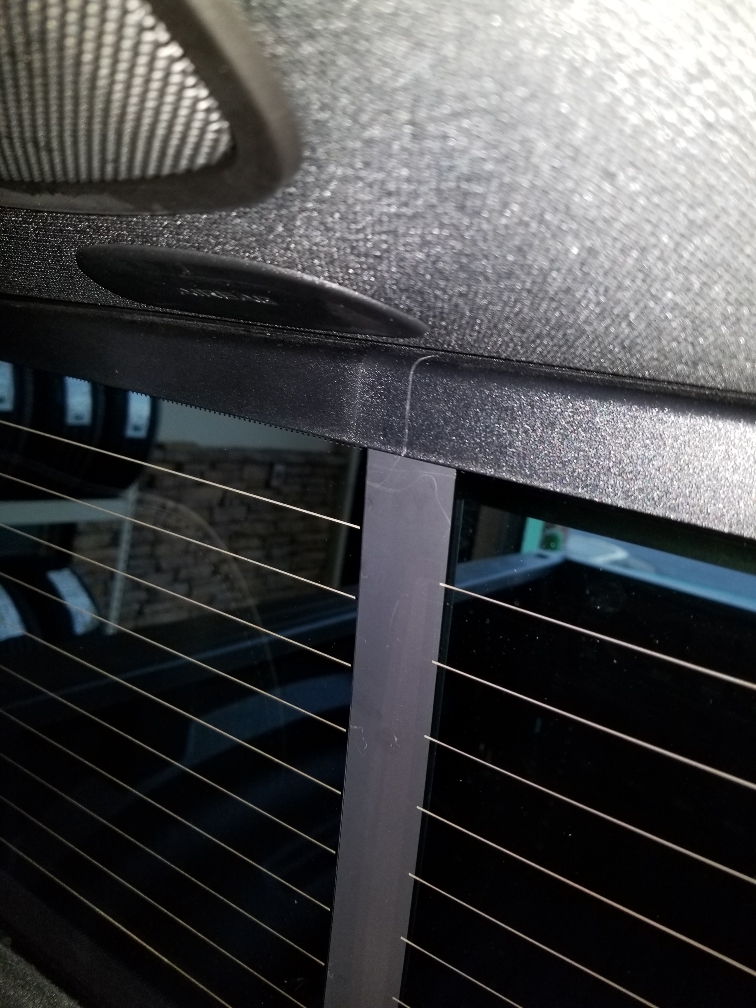

I just just dropped my 2019 1500 Big Horn off at the dealer to get it checked out. I’ve got a crack on both sides of the power window on the plastic window surround. I’ve got 60,000 miles so I’m pretty sure the dealer is going to say I’ll have to pay out of pocket. I’ve already opened a case with Ram Cares. Hopefully they can step in and help out since this is obviously a defect.
The dealership called me and said they would have to replace the back window and it would be around $1000 plus labor. I’ve got 60,000 miles so I’m out of warranty. They said it wasn’t a common problem and there wasn’t anything they could do. I’m ready to sell my Ram.

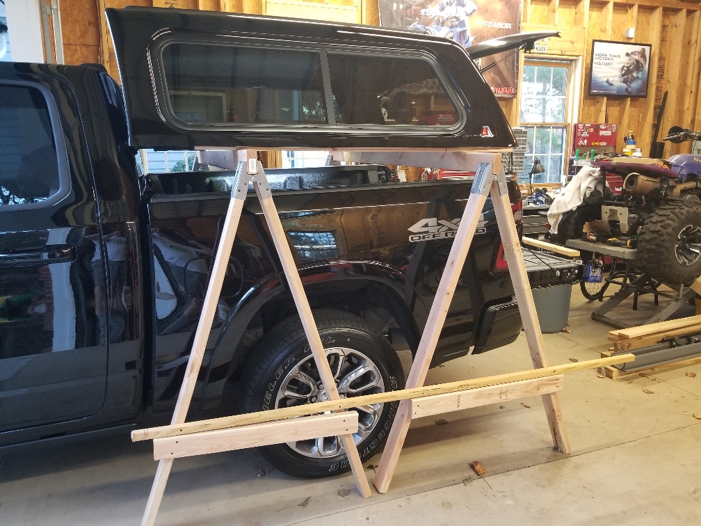

Unfortumatly for me, I just put a cap on the truck. So I removed the cap, dealer tested and duplicated the leak. Ordered a new rear window. And scheduled their local glass guy to replace it, which was only two days later. The dealers technicians removed the rear seat and headliner trim, had the glass guy swap the rear window, and the technician buttoned it back up.
I checked thoroughly for any damage, and thankfully found none. Besides them not vacuuming their mess, and wiping down their fingerprints, including the glass. I was satisfied.
I did notice that the glass guy placed a large bead of Ultra Black silicone along the outside window frame, that is primarily covered with the trim surrond.
So the glass guy did a CMA thing... It should hold up non the less.

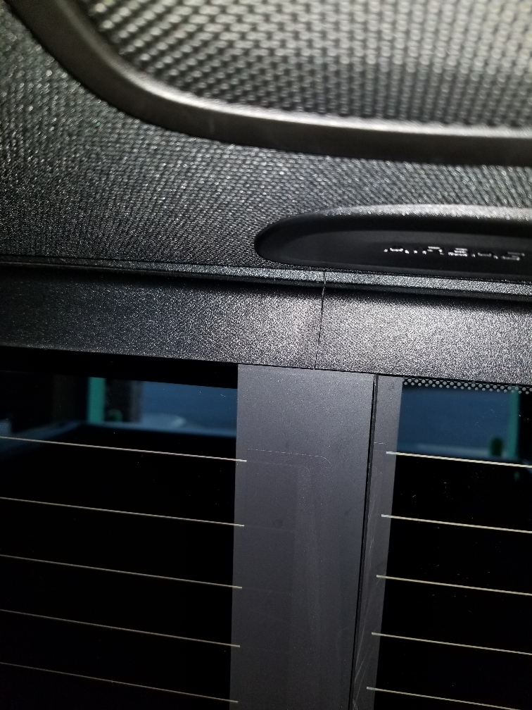

Add me to the list. Found a crack a small leak this morning.... 15k on truck so I’m still under warranty. Those folks who are getting it fixed, are you happy with the outcome ? It’s been my experience when you change out the factory glass or frame it’ll never be right again...
Same here. 17K and found a crack in driver side rear. Spoke to a local service manager and he said they’ve done 4 replacements. Sadly he said looks like the part number has yet to be updated so this theoretically could happen again with the new one
EDIT: dealer wanted me to schedule couple days out and drop off vehicle. Didn’t feel like waiting so I just stopped by. Caught them off guard and they ended up
taking photos on the spot and cancelling my appointment. Guess in person they can’t hide told me they have a guy who’s been waiting 3 weeks, so They have submitted my warranty claim and will call me when approved / window ordered
