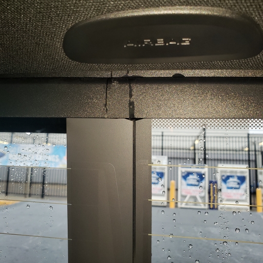

Rear window surround crack.
Could this be more of a third break light issue?
Also any 2019 build owners having this problem?
At the car wash today and now I’m seeing the same issue. Mine was a May 2018 build bought new in December.
Taking it in soon for another faulty backup camera, squeaky brakes and recalls.

I noticed mine is leaking in this spot with a damp headliner, I don't have any cracks however. Guess I have to make trip to the dealer. Build 8/18
Just went out to the truck. I have leaking at the back window same spot but no crack with damp headliner with Fixed sunroof drains. Nov 18 built
Can you post a picture to show exactly where the leak is. Also is the back carpeting under the window wet.
Leaking 3rd is also known issue. There's a TSB.
Geotex1, any idea on the TSB? I don't see it anywhere on the listed TSBs. Unfortunately, after almost a year and 12k, I have the dreaded issue of cracked frame and water intrusion.
Cracked and evidence of very minor water intrusion. The crack goes way up, most likely all the way to outside.

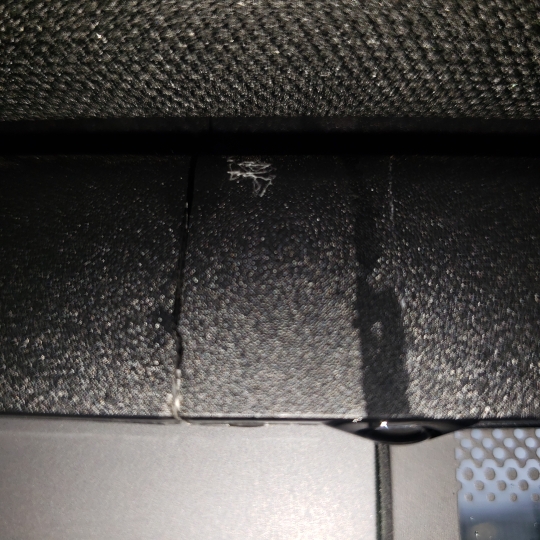

This is a very recent development, was fine about a month ago.IMGP5126 1600 crack..jpg
April 2018 build. 21k miles.

Mine is going to selling dealer this Friday. I asked the service advisor if they had seen any trucks with this issue, they said they hadn't. Will keep this thread updated as issue progresses. My build date is 8/18, so I am seeing a very small trend with us responding to this thread.
Sigh - I've got 2 cracks and a trip through the carwash confirmed water getting inside.
This is a very recent development, was fine about a month ago.View attachment 39322
