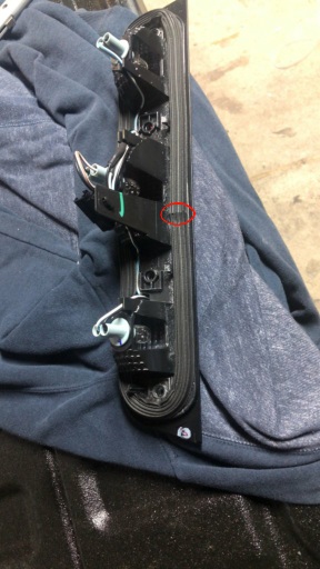

I would def start with the brake light. Mine was dripping from the headliner area and I also do not have cracks. Replacing the seal on the brake light fixed mine.
I’m not sure if u have already but would u mind posting a link to the seal u used to replace the stock one? Thanks
What did you used to seal them together( end to end)?
You can put a dab of adhesive rtv or silicon. Rtv sticks to almost every kind of gasket. You can also use the 3m weatherstrip adhesive
