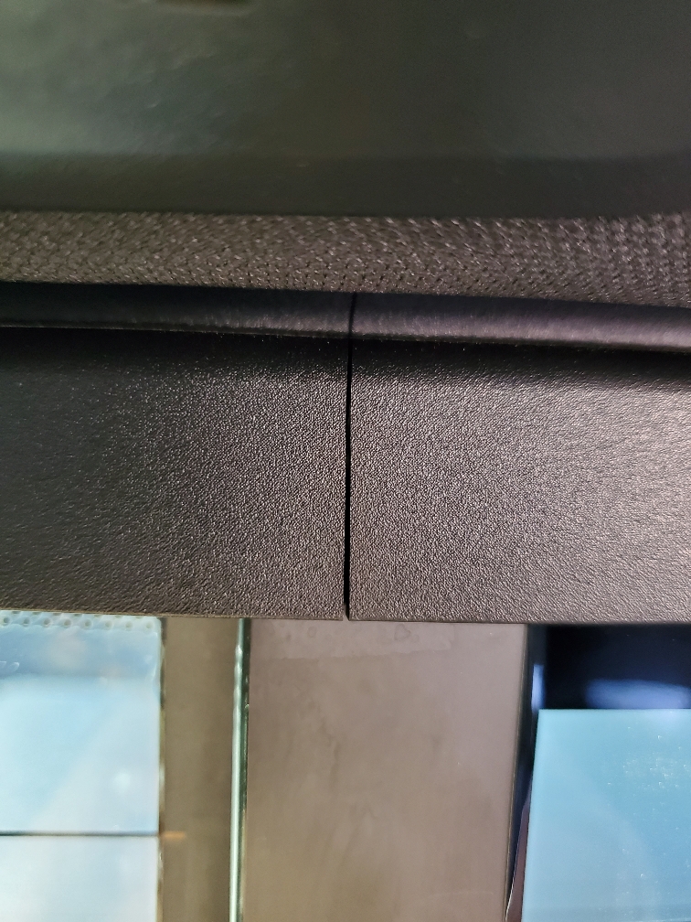

This picture of the crack i took back in January, it show cracked line but i never seen water or wet spot anywhere. Today i bring the car in for 2 recall (W33 and W25) so i show my advisor the crack, he said he will have tech looking into and call me. Anyway after couple hrs he called, recall taken care and the rear window need to replace, they got 1 in stock so he will keep the car and replace it, should be done next day.
Got all of it taken care of, will see how the new rear window doing.
