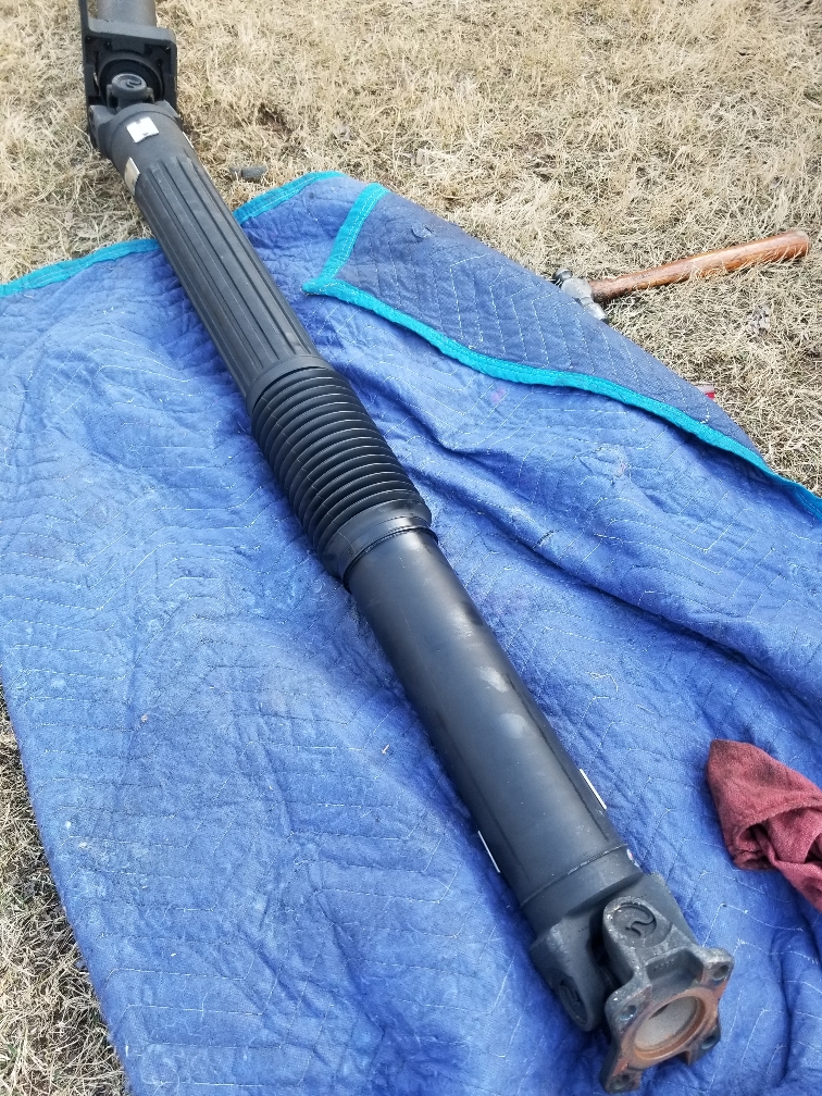

Lack of grease in the rear area of this strange design of a drive shaft. You have to remove the rear end of drive shaft (4 bolts, 2 bolts holding a support bracket toward middle). Then the clamp closest to the rear of truck on dust cover has to be cut off (factory locked), then the rear of shaft slides out from the ridged area and I'm sure you will find lack of lubrication. Grease it up real good and slide it back in. Waalaaa, mine is smooth as butter now, no more of the "Ram clunk".
Can you post a pic of the clamp that you replaced? I'm fixing to do this repair and I'm not sure if it is the one on the boot of the rear driveshaft or if there is one at carrier bearing in the middle.

I’m convinced it’s driveline slop. Like your efforts show, when greased it’s fine. Mine is totally temp related which indicates clearances and lubrication issues in my opinion. A new drive shaft is about $700 from a wholesale mopar parts dealer. I wonder if anyone has tried a one piece custom unit.

I finally found time to get into this issue again and after reading posts about fords and gm having the same issue I pulled the trigger and ordered the Ford PFTE Teflon spline lube. Our shop manager used to work at a Ford dealer and said that after using that grease he never had customers return with the clunk issue.
My drive shaft splines were greased with red grease from the factory but very little of a film. I cleaned that off all surfaces and liberally applied about 2oz of a 3oz tube of Teflon grease. NO MORE BUMPS! I can come and go from a stop and even cycle my suspension up and down, and there is no noise or bump to be felt! Amazing. I wish the dealer would have solved this, but I am happy it only took a $12 tube of grease and two hose clamps for the boot.

I would try re-lubricating your driveshaft. 1-2 hrs and a cheap tube of Ford XG-8 Teflon grease is worth a shot. I ordered mine from the local Ford dealer and it was $12 or so.
IIRC it was torque the rear driveshaft bolts to 81ftlb and 42ftlb for the two carrier bearing hanger bolts. All 15mm socket.
