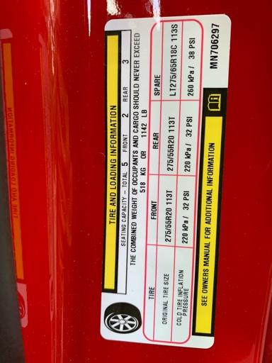

Please post your Tire and Loading sticker

So, I found a truck optioned almost the exact same as mine and plugged the VIN into the "Lookup my vehicle" link on the Ram website. The payload showed as 1242#. This truck had the sunroof and cold weather package, which mine will not have, so I'm thinking I'll be pretty close to my 1300# minimum goal on payload. Am I thinking correctly?
Somehow my tire and loading sticker was ripped off either from the factory or at the dealer, I didn't notice it when I picked it up. Ram customer care and the dealer are both useless, going on 4 months now and I'm still "waiting for the dealer" to figure out how to get a replacement. Crazy. So all I have to go by is the numbers on the website.

MAX PAYLOAD
958.41LBS
MAX TOWING
10858.41LBS

I’m all of 167 pounds above you. My Laramie had a payload of nearly 1700. I knew the Longhorn would be lower, but I didn’t fully comprehend how much lower.
I didn’t get the MFT or Rambox, but I did get the off-road group. That, the sunroof, and the 33 gallon tank are what hurt my payload the most.
Most of the time, it won’t be an issue. But on road trips when I’m taking the rooftop tent, a powered cooler we just bought, our “stuff”, a Front Runner rack, and a Retrax cover, we might be pushing it.
