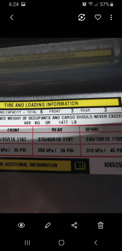

Please post your Tire and Loading sticker

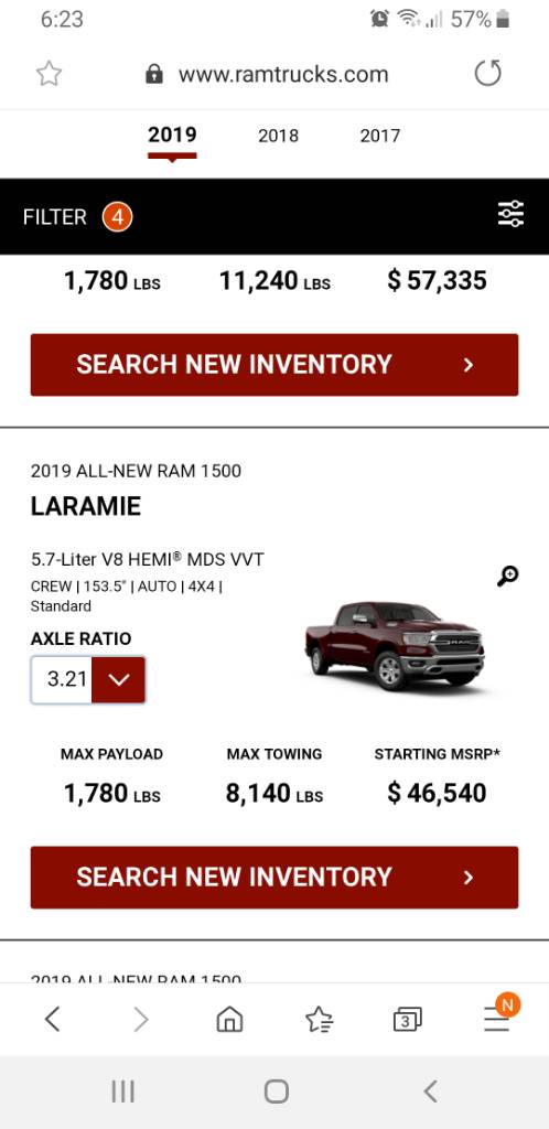

Can someone enlighten me? My jamb sticker shows 300 pounds less payload than what's on Rams website for a Laramie. My only options to this trim are LSD, trailer brake control and navigation. I cant imagine those add an extra 300 lbs. What am I missing?

Thank you I made the mistake of looking at a dealership website
Sent from my SM-G960U1 using Tapatalk
The Ram website is generic (not specific to the Laramie). In this case it lists the MAXIMUM payload for a 1500/crew/4x4/long bed, lowest trim and basically no options. Misleading isn’t it.
Well, that's dumb. Why even list the different trims on the payload page? Thanks for clearing that up. Sorry of it's been covered already.

I think that’s just the way it works for all the manufacturers. I’m researching a Limited trim CC 4x4 5.7 short bed. Towing chart says ~1800 pounds max payload but we know from the payload stickers we’ve seen that actual payload for this trim is ~1400-1500.
I’ve been looking at a Platinum F150 also. There its even more misleading. They claim max payload of 3000+ pounds (they don’t break it down as well as Ram does for each engine/cab/bed/driveline combination in their towing guide). Well the actual payload stickers for the Platinum trim are in the same range as the Ram ~1400-1500lbs.
